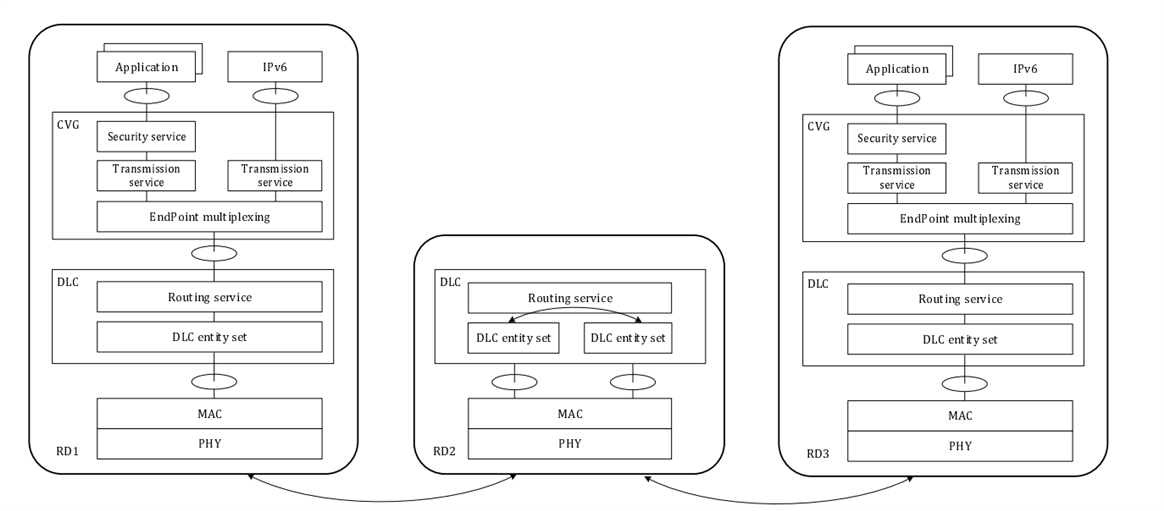

Another thing to note is that DECT NR+ defines many of its core features, like routing and re-transmitting packets, on the radio stack level. This enables multi-core systems to carry out reliable radio communications without needing to wake up other cores, limiting the device's power usage.
