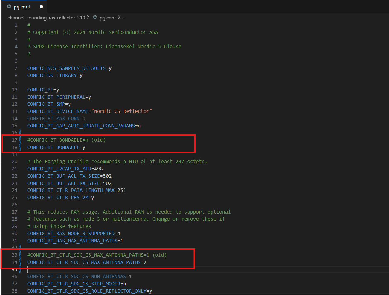

The first step is to build and flash the Channel Sounding Reflector with Ranging Responder sample on to your nRF54L15 DK. To configure the Reflector sample from nRF Connect SDK to work with your Android smartphone, set the "Extra KConfig fragments" to include android_ranging.conf.
Once you've added the android_ranging.conf to your build configuration, build the sample and flash it to your nRF54L15 DK. The preparations are now done, and you can move on to running a quick demo with your smartphone and the nRF54L15 DK Reflector.

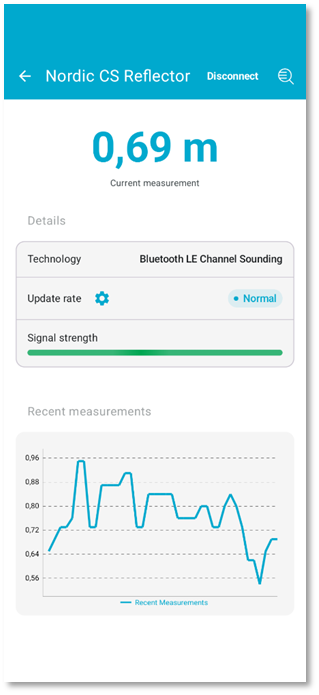

The screenshot below shows how the UI on the nRF Toolbox app looks when Channel Sounding is enabled, and the measurements are active.
The view on the nRF Toolbox app when the Channel Sounding procedure is running.

  • Apologies for the late response, but indeed you are correct. Pixel 10 contains dual Bluetooth antennas.

  • I note that the above states " and the number of Channel Sounding antenna paths must be configured to 2". Does that mean that the Pixel 10 has dual Bluetooth antennas, since I believe the DK only has a single antenna?
