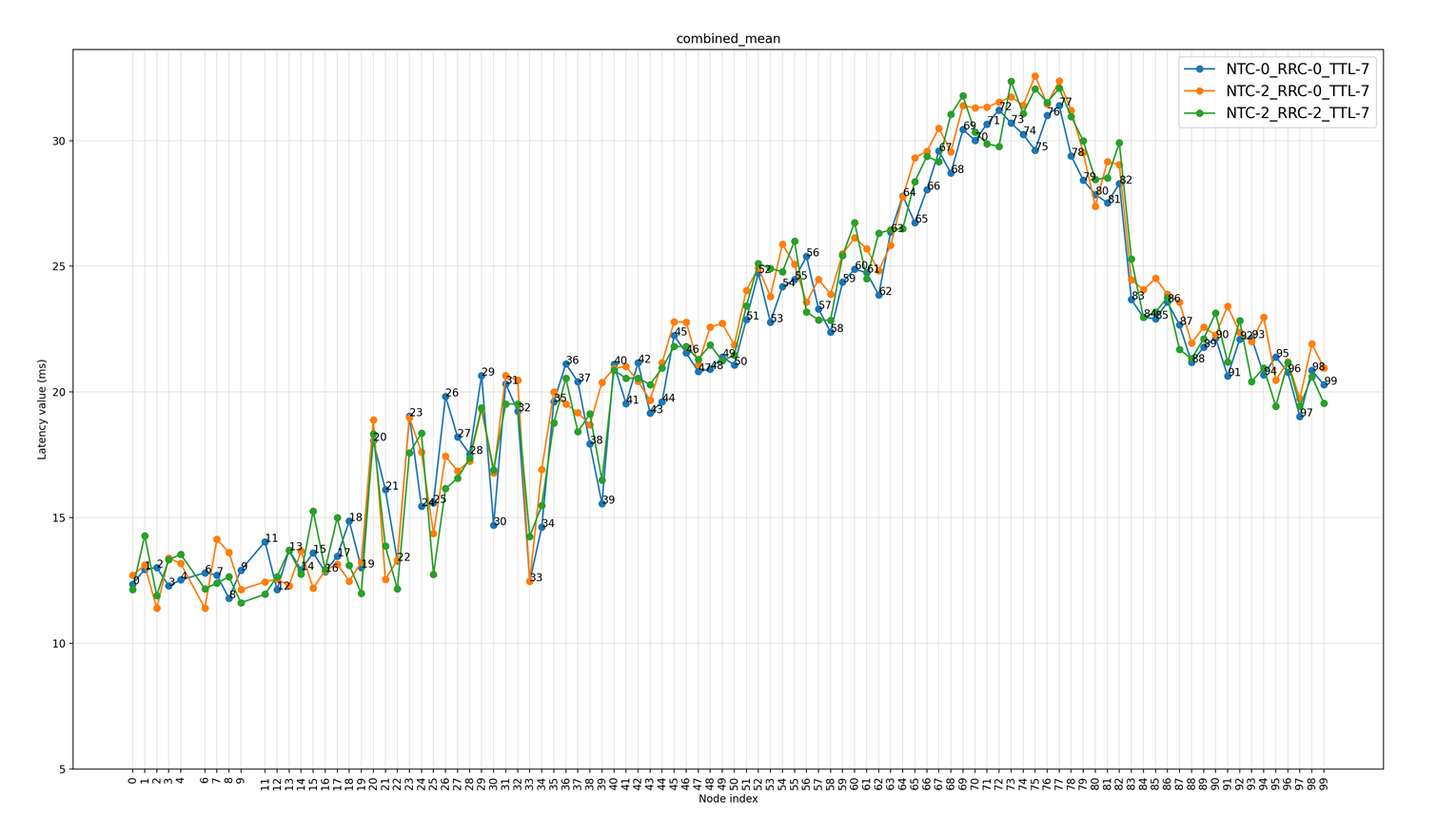

Results and discussion
With unacknowledged messages
Latency measurements
All nodes are relays
The following figure shows the plot of the average (mean) latency for each node in the network when all nodes are configured as relays. Plots show combined results for three scenarios - scenarios 1, 2, and 3 as mentioned in Table 4.
Figure 4: Mean latency (Unacknowledged messages) for each node for three scenarios when all nodes are relays
Inferences
  • The latency plot against the node index shows a pattern that matches the topology of the network. As the building floor is ‘C’ shaped, nodes towards the second fork of the floor are farthest away from the tester node in terms of the number of hops.
    • Some of the nodes (nodes 20, 23, 26, etc.) have particularly high average latency compared to neighboring nodes. This may be because these nodes are located at such a location that requires more hops for successful message delivery, thereby pushing the average latency higher.
      For example, node 20 is located behind several obstacles from the tester (node 5). Therefore, most messages it receives are via slightly more hops compared to node 19 and node 22, which have more direct and shorter paths from the hop before.
  • For unacknowledged messages, one-way latency performance is fairly uniform across different scenarios of Network Transmit Count and Relay Retransmit Count values.
    • This could be explained by the fact that all nodes act as relays, and the test procedure ensures that the overall network is quiet before sending each message.
    • Secondly, as no response messages originate from the destination node, the relays in the network do not suffer many collisions while relaying packets.
    • However, an increase in Network Transmit Count and Relay Retransmit Count values generates more traffic and slightly degrades mean one-way latency values for some of the nodes.

The following figure shows the plot of the average (mean) latency for each node in the network when all nodes are configured as relays. Plots show combined results for three scenarios - scenarios 1, 2, and 3, as mentioned in Table 4.
Figure 6: Mean Round Trip Time (RTT) latency (acknowledged messages) for each node for three scenarios when all nodes are relays
Inferences
  • There is a marginal difference between the mean latency values for different numbers of Network Retransmission Count values.
  • When Relay Retransmit, Count is increased to two:
    1. Round-trip latency values are significantly high for the nodes further away from the tester node. This is expected as there will be a burst of traffic in the network due to all nodes relaying packets, leading to more interference and loss and hence affecting the average latency.
    2. Some of the areas have a high concentration of relay nodes (between node index 20 to 36, see Figure 2) since all nodes are acting as relays, causing bursts of traffic and this affects the latency in the neighborhood severely.
      1. This implies that a reduction in the number of relays is necessary to optimize network performance.
Some nodes are relays
The following figure shows the plot of the average (mean) latency for each node in the network when some nodes are configured as relays. Plots show combined results for three scenarios - scenarios 4, 5, and 6, as mentioned in Table 4.
Figure 7: Mean RTT latency (acknowledged messages) for each node for three scenarios when some nodes are relays
Inferences
  • When a limited number of nodes are configured as relays, there is some increase in round-trip latency value.
  • Many nodes with limited relays around them have reduced round-trip latency values (compared to the previous scenario) as the total number of relays in the vicinity is reduced leading to lesser losses due to collisions. This is specially visible in high traffic scenario (NTC=2, RRC=2) and for some of the farthest nodes.
  • However, though the reduction in the number of relay nodes helps reduce overall traffic, for some nodes, the short hops that were available via redundant relays are no longer available. This is especially true for the farthest nodes and increases average latency for those nodes when smaller number of retransmits are used.
  • When Relay Retransmit Count (RRC) is increased to two:
    1. Latency values are more or less similar to the case when RRC was set to zero. Variations could be related to density of relays and distance from the relays for various nodes.
    2. Some areas still have a high concentration of relay nodes (between node index 20 to 36), which is reflected in higher latency values.
      1. This indicates that there is still scope for improvement by reducing the number of relays even more and to optimize relay selections.
