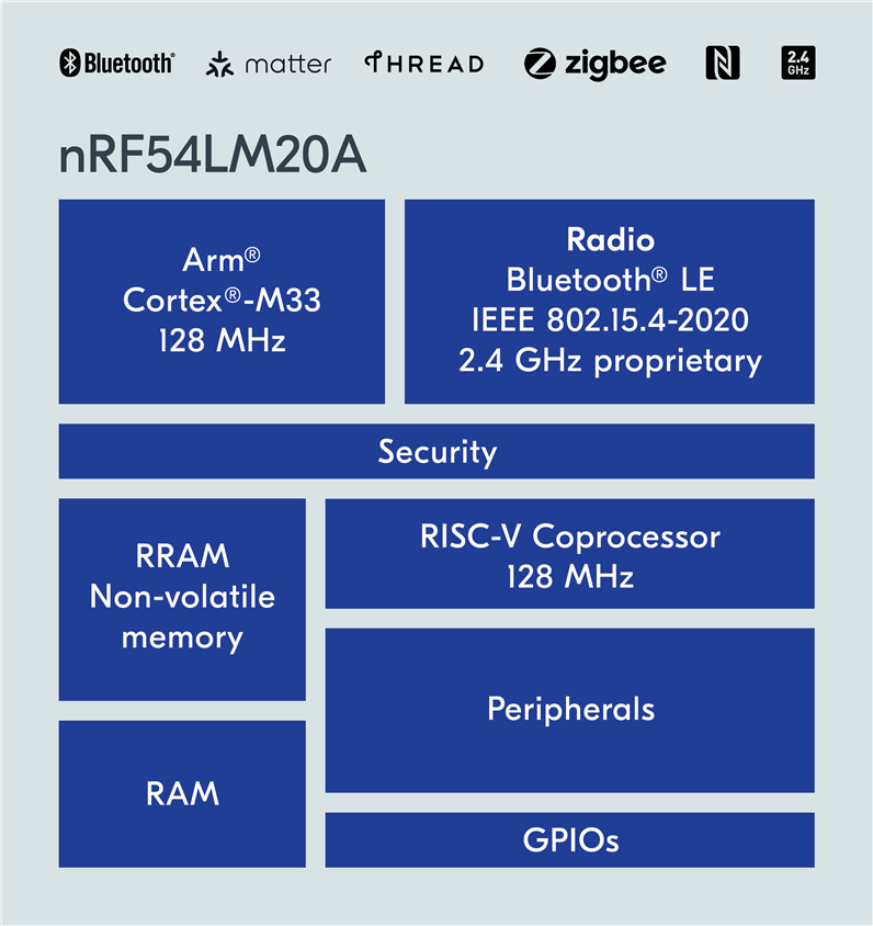

The diagram below shows the high-level architecture of the nRF54LM20A.

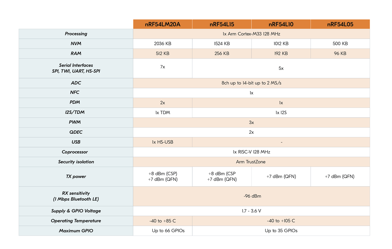

With the addition of the nRF54LM20A, the nRF54L Series now contains four SoCs. The table below gives an overview of the four SoC and their features.
