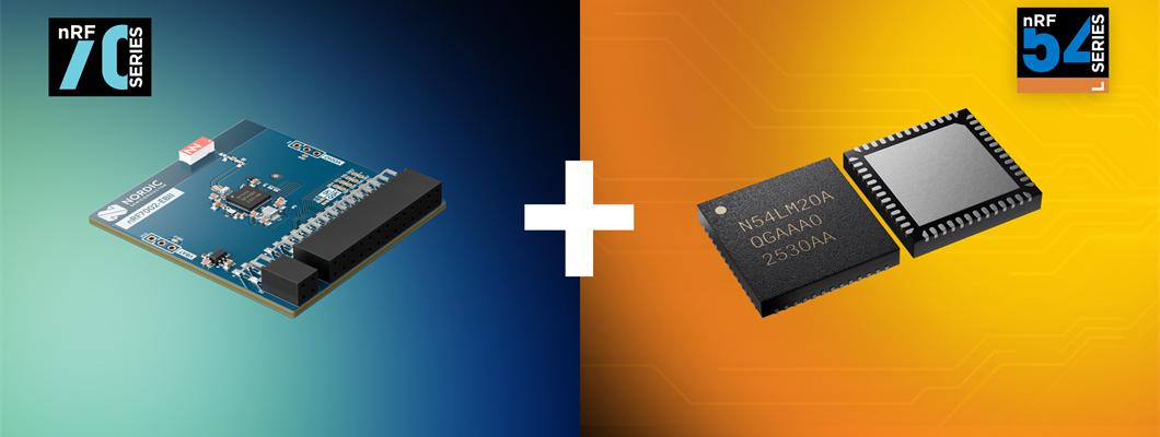

Nordic powers robust low-power dual-band Wi-Fi 6 with nRF54LM20A and nRF70 Series
Nordic Semiconductor is enabling full-featured Wi-Fi 6© applications on the nRF54LM20A SoC, paired with the nRF70 Series companion ICs. This powerful combination provides developers with the hardware and software tools needed to evaluate multi-protocol stack support and build next-generation connected products.

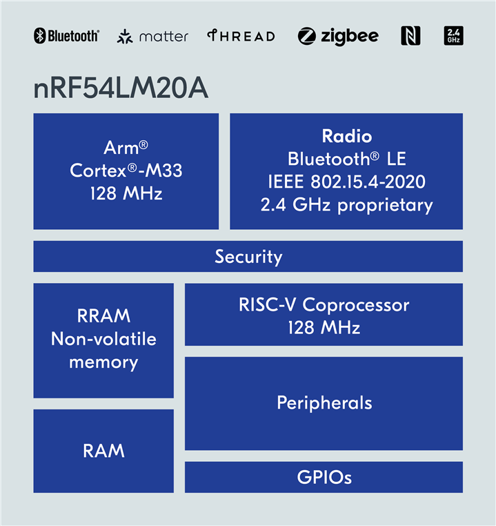

Why nRF54LM20A?
The nRF54LM20A is Nordic’s latest addition to the nRF54L series of wireless SoCs. Featuring the highest memory configuration among the nRF54L series, it is an ideal host microcontroller for Wi-Fi applications that require larger NVM and lower system current consumption. All devices in the nRF54L series offer improvements over previous generations, making it the go-to platform for Matter, Aliro, and other advanced IoT protocols.
SoC architecture and highlights
The nRF54LM20A features:
  • Processor: Arm Cortex-M33 128 MHz
  • CoreMark score: 503 CoreMark®, 3.93 CoreMark/MHz (executing from non-volatile memory)
  • Memory: 2 MB on-chip NVM and 512 KB SRAM
  • Security: Trusted execution environment enabled by TrustZone, tamper detection, and a cryptographic accelerator protected against side-channel attacks
  • Peripherals: HW SPI for nRF70 Series interface, sQSPI available as SoftPeripheral on RISC-V coprocessor
  • Radio: 4th generation 2.4 GHz multiprotocol radio supporting Bluetooth LE and Channel Sounding.
  • Power: Significantly reduced with low-power-oriented architecture, individually controllable power domains, unique Nordic technologies and progression to 22nm process.
The nRF54LM20A delivers a leap in integration flexibility and future-proof memory capacity, while improving on current consumption and raw functionality, such as USB and up to 66 GPIOs.
nRF54LM20A is the ideal host for low-power Wi-Fi
The nRF54LM20A is an ideal choice for memory-intensive applications, such as hosting the Wi-Fi networking stack for the nRF70 Series. Along with ample on-chip RAM and NVM, nRF54LM20A supports several key features required for low power applications with the nRF70 companion devices:
  • SPI ensures efficient communication with the nRF7002 Wi-Fi 6 companion IC
  • QSPI emulation using SoftPeripherals with the RISC-V coprocessor allows for higher Wi-Fi data throughput
  • Low-power architecture with unique RRAM-based NVM with fast wake and low leakage, ultra low current consumption in SoC Idle and SystemOFF modes, as well as low power transmit and receive operations with the 2.4 GHz multi-protocol radio.
  • Standalone operation with the nRF7002 as a companion IC allows the nRF54LM20A host to stay in sleep mode, while the nRF7002 maintains association with the Wi-Fi access point. In the absence of Wi-Fi traffic the nRF54LM20A can support Wi-Fi connected stand-by operation while remaining entirely in System ON Idle state.
The above feature set makes nRF54LM20A ideal for smart home applications powered by Matter, which rely on Wi-Fi for OTA updates, local device access, cloud synchronization, or secondary communication alongside the Bluetooth LE or Thread radio.

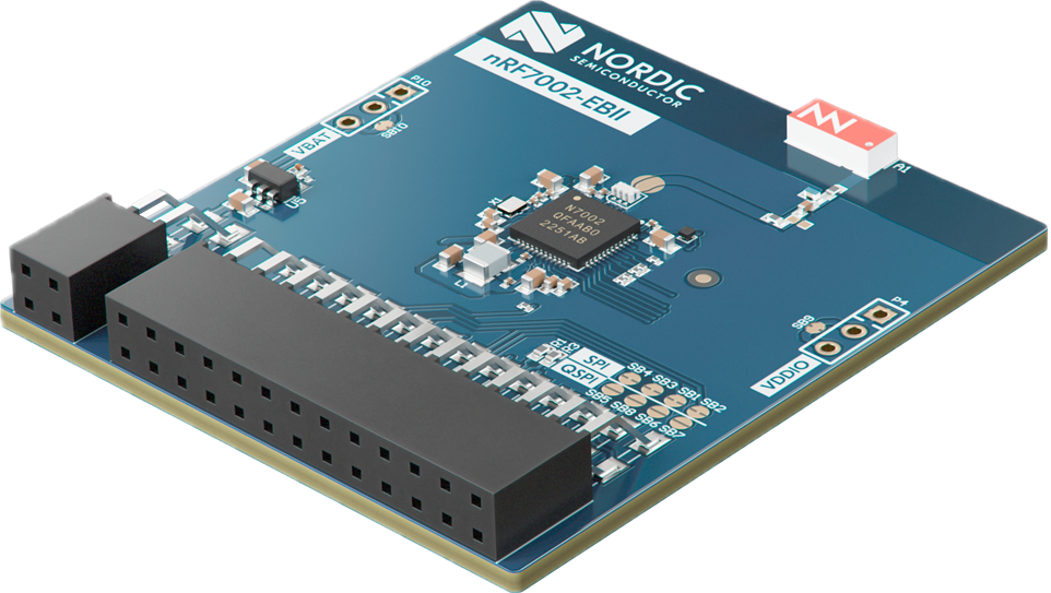

Evaluation hardware: nRF7002-EB II
To help developers evaluate their Wi-Fi applications on nRF54LM20A, Nordic plans to release a new Wi-Fi Expansion Board with the nRF7002 companion IC with plug-and-play support for the nRF54LM20 DK.
The new expansion board (nRF7002 EB II) will be compatible with the latest development kits for the nRF54 Series devices. Key features include:
  • Dual-band Wi-Fi 6: 2.4 GHz & 5 GHz low-power Wi-Fi 6 connectivity via the nRF7002 companion IC
  • Host Interface: SPI communication with co-existence support
  • Design Focus: Optimized for nRF54LM20 DK and future DK compatibility
  • Software Support: nRF Connect SDK v3.2.0 onward
Getting started with nRF7002 and nRF54LM20A
While the nRF7002 EB II has not yet been officially released, initial support for the expansion board is already present in the nRF Connect SDK along with documentation for how to build and run Wi-Fi example applications on the nRF54L Series DKs.
Logs of successful connection are provided below, based on the Wi-Fi Shell application in the nRF Connect SDK on the nRF54LM20A target.
