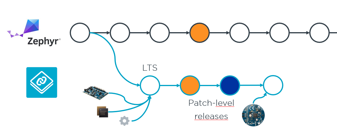

The nRF Connect SDK version 3.4.0 will be the first LTS release. The patch-level versions will be version 3.4.1, 3.4.2, etc. Because these patch versions will be based on the same branch, they will not have unrelated breaking changes that could be coming from upstream Zephyr, or changes in libraries and protocol versions. This will ensure customers a simpler integration path, and quicker response times to deal with issues related to critical security vulnerabilities affecting devices in the field.
Addition of new devices and boards
Patch-level releases will not limited to just bugs and fixes for security vulnerabilities. Support for new Nordic SoCs and boards can also be added to the LTS with a new patch-level release.
Today, devices and boards are added at upstream Zephyr first, and then make their way to the SDK with every new fork for a release. Adding new devices in patch level releases of the LTS gives a solid software foundation from day one, and does not hold customers back until a new fork for a release is done.
It’s important to highlight that the new devices and boards may also be in parallel ported to upstream Zephyr, to contribute with the community and keep the the upstream project updated with latest Nordic Semiconductor parts.
branch sample
Simplified diagram of how porting a fix from upstream (orange), adding a Nordic fix (blue), or a new board to the LTS, will look like, based in the same LTS branch

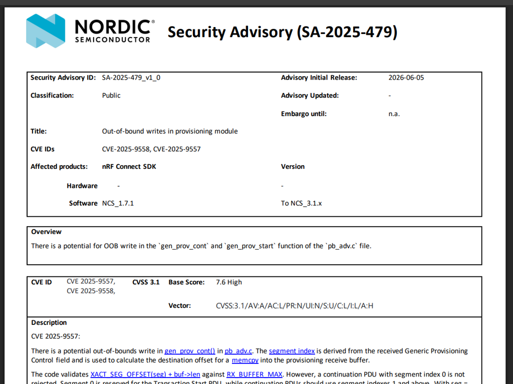

There is no predefined calendar for patch-level releases, as they will depend on when security vulnerabilities or major bugs are discovered, reported, and their severity. Even though these could be patched in the source code tree very quickly, it does not mean a new full patch-level release will be created every time a new single vulnerability is reported. It’s more likely releases will be created periodically, when a certain number of fixes is reached, while keeping the interval within the legal required timeframe.
Users can expect to find information about issues at the TechDocs Security Advisories section. Such information will contain a description of the affected products, if it is linked with a public item listed in Common Vulnerabilities and Exposures (CVE), its base score as indicative of the severity, etc. It will also contain a way to address it, or a version where this problem was fixed.
security advisory sample
Sample of a security advisory notification

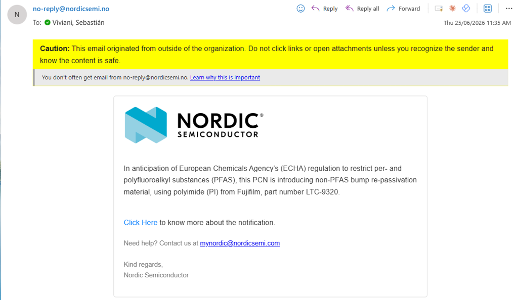

Getting notifications about new bugs and security vulnerabilities
Instead of periodically checking the TechDocs website, customers can also get notifications about new issues relevant to their projects by using the myNordic service.
myNordic is the single sign-on and notification hub now being rolled out across Nordic Semiconductor platforms. Users can control what notifications they can subscribe to, depending on the hardware or software component used in their project.
e-mail notification sample
Sample of a myNordic e-mail notification
