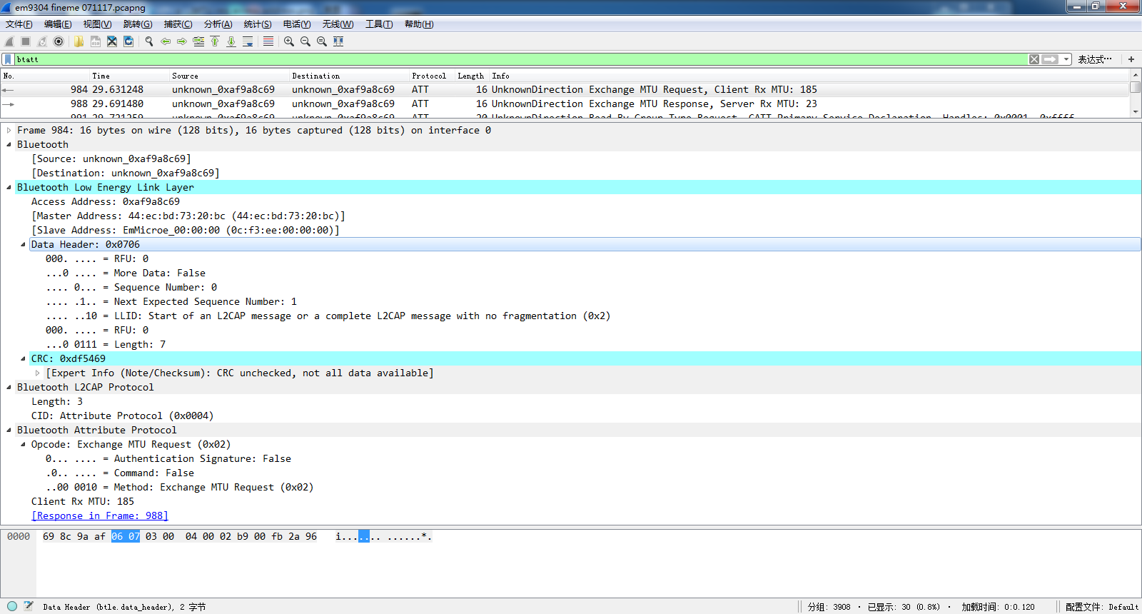

  1. MTU REQEUST Complete data (marked by blue color)
image description
1) Access Address: 0xaf9a8c69
Fixed 4 bytes,specified by CONNECT_REQ(see:http://www.viewtool.com/forum/vi ... &extra=page%3D1)
image description
  1. Header Info  Data Header: 0x0706 000. .... = RFU: 0 ...0 .... = More Data: False .... 0... = Sequence Number: 0 .... .1.. = Next Expected Sequence Number: 1 .... ..10 = LLID: Start of an L2CAP message or a complete L2CAP message with no fragmentation (0x2)
  1. .... = RFU: 0 ...0 0111 = Length: 7
image description
 3) L2CAP Length In BLE protocol layer,All of GAP,GATT and SMP use L2CAP channel to transfer command to LINK LAYER,L2CAP packing need to specify L2CAP length and channel ID Length: 3
image description
  1. L2CAP CID:channel ID CID: Attribute Protocol (0x0004)
image description
5) ATT command
 standard:
image description
 actual data package:
Opcode: Exchange MTU Request (0x02)
0... .... = Authentication Signature: False
.0.. .... = Command: False
..00 0010 = Method: Exchange MTU Request (0x02)
image description
  1. MTU value (requested) Client Rx MTU: 185
image description
  1. CRC
image description
