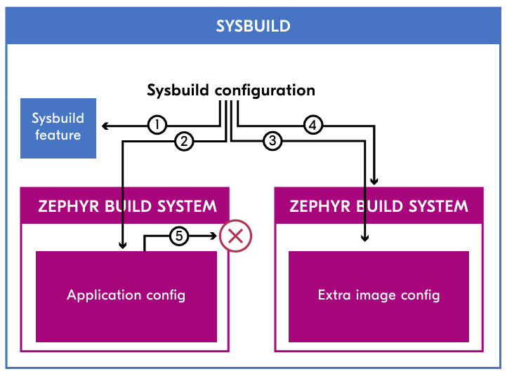

Sysbuild configuration rules
Sysbuild can configure the other images in the build system, but the images can not apply configuration to each other or to Sysbuild.
The image depicts the Sysbuild configuration rules:
  1. Sysbuild configuration can add a feature that affects only Sysbuild.
  2. Sysbuild configuration can cause changes in the application configuration.
  3. Sysbuild configuration can cause changes in the extra image configuration.
  4. Sysbuild configuration can spawn new images.
  5. Application configuration cannot affect Sysbuild configuration or Extra image configuration.
