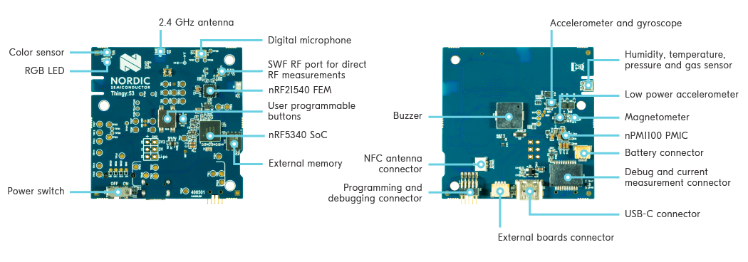

The Thingy:53 integrates the nRF5340 System on Chip (SoC), supporting Bluetooth Low Energy, 802.15.4, a Near Field Communication (NFC) passive tag, and the nRF21540 RF Front-End Module (FEM) for extended range. In addition, it has the nPM1100 Power Management IC (PMIC) for power management and battery charging of the 1350mA Li-Po battery.
The NFC in Nordic Thingy:53 operates as a passive tag (i.e. it does not feature a reader function).
There are two 2.4GHz antennae, one connected to the nRF5340 through an RF switch for TX output power up to +3dBm, while the second connects to the nRF21540 RF FEM, with TX output power up to +20dBm.
