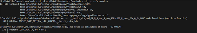

I am quite new to Nordic boards. I need to figure out how to output PWM signal to GPIO pins. I went through Nordic's tutorial to get started. However, I could not figure out how to use overlays and perform pin assignment. What I want to do is assign PWM0 to gpio0 14 and import the driver in my main code. I always get same error shown in the image.  Any hep appreciated. Thank you.

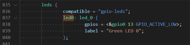

    2. As the main code uses led0, Open compiled device tree and look node label led0
    you will find that the led0 is connected to the gpio0 pin 13

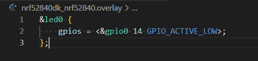

    3. To change pin assignment for le0, we need to do so in an overlay file. Therefore, I created file called nrf52840dk_nrf52840.overlay (file name need to be specific as per your board) and assigned it to pin number 14
    4. After building and flashing, you will see that now LED2 (top right led on the DK) starts blinking
