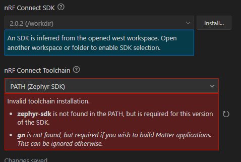

Configuration and compilation a sample project in commandline works fine. However, problems arise when I want to use the nRF Connect extansion ( nRF Connect for VS Code - Visual Studio Marketplace ). In the welcome screen, it cannot find the SDK, showing the following message (see image)
When I set the path to /workdir, (where the zephyr-sdk directory resides), it says enigmatically:
Has anyone succeeded in setting up this extension in a devcontainer?
