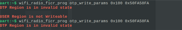

Hi all,
Recently I tried to program the FICR customer-programmable region of a new nRF7002 IC on a custom board.

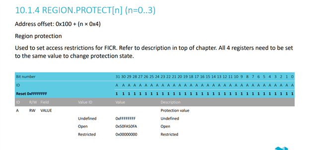

During the learning process, I messed up by writing an invalid value to the REGION.PROTECT (attached) 0xFA50FA50 instead of 0x50FA50FA
Now on the shell command window, I cannot read or write into this register or any other register.
Is there a way I could perform a chip erase to set it back to the factory default setting since the current MAC address in this chip is 0 so it can not be used for any wifi application? Thanks a lot in advance.
