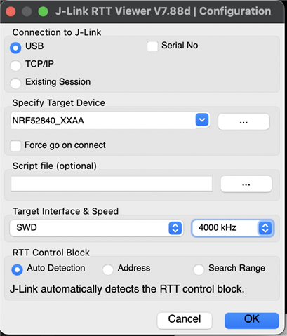

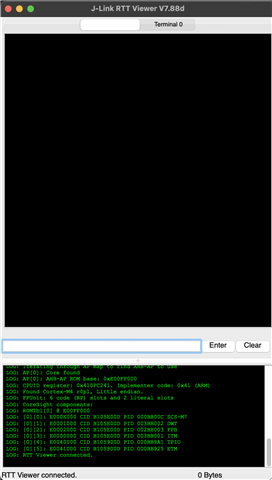

After setting the flags in sdk_config, I still don't see any prints in the RTT viewer with these settings
Q1: Which project in the SDK are you testing with?
Q2: Could you please share your sdk_config.h?
Håkon
0714.sdk_config.h
nRF5_SDK_17.1.0_ddde560
Any idea?
The sdk_config.h looks good.
Did you try other examples with similar settings for RTT?
Håkon
Yes I have. Is there anything wrong I'm doing with RTTViewer itself? Please guide
I am not sure why it does not work, your configuration should be good.
Q1: Are you testing on a nRF52840-DK? If not, can you try on a DK?
Q2: Does the firmware running on the nRF run as expected at this point in time?
Q3: If you enter debug mode, is it stuck somewhere?
Håkon
if you aren't sure, please assign this ticket to someone more senior perhaps? Also your replies are super late
Can you please try this file?
This is ble_app_hrs, compiled with RTT backend support:
Output in JLinkRTTViewer:
If it still does not work, I would recommend that you contact Segger and report a bug related to the RTTViewer software.
