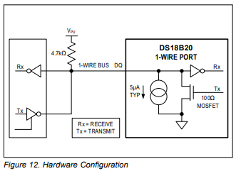

    It says you should hook up the hardware as descrbed in DS18B20 datasheet, the figure I can find that show this is:

    The nrd52840dk_nrf52840.overlay files says it should use port1 pin1 for uart rx and port1 pin2 for uart tx. Looking at the hardware configuration figure above I can see you need a ~4.7kohm pull up on the 1-wire line, however I can also see from the overlay files that there is an bias-pull-up; option used for uart rx, so with this option you should not need an external pull-up, instead simply connect the rx and tx together with the DQ pin of the DS18B20 should be sufficient.
