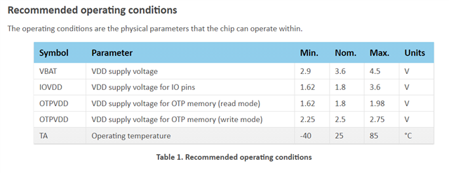

  • Quick followup question: if 3.3V is supplied to the nrf5340's VDD pin, the GPIO voltage would then be 3.3V, right?
    If I design a custom PCB and supply 3.3V to the nrf5340's VDD pin, are there any nuances to be aware of? I think I would likely have to also supply 3.3V to the IOVDD of the nrf7002, right (since the nrf5340 and nrf7002 communicate using QSPI)?
    IOVDD on the nRF7002 should be the same as the GPIO voltage of the nRF5340, yes.

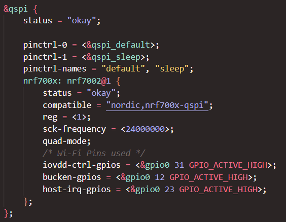

  • Got it, thank you. I can also avoid errata 136 by running the QSPI at a different clock frequency right?
    Do you know what default clock frequency the QSPI operates at for the nrf7002dk? If I create a build configuration for nrf7002dk_nrf5340_cpuapp, I see this in the devicetree:
    Does this mean the QSPI clock frequency is 24 MHz? So powering the nrf5340 with 3.3V shouldn't be an issue then?
    If I did want to change the clock frequency, would I simply need to just change the value of sck-frequency in the devicetree?
    I would like to run code on the PCB I am designing that requires as little modification from the wifi scan sample as possible.
    I must admit I wasn't aware of this, but it seems 24 MHz is the default frequency, yes. As such you should be able to run the communication at 3.3V if you want. This hasn't been tested extensively on our side though, so I can't guarantee that there will be no side effects.
    Yes, that should be sufficient.
