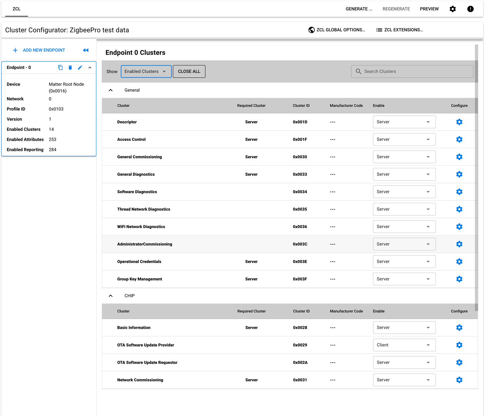

Matter template sample - fails to build after touching with ZAP tool
Hi - I am using NRF SDK v.2.3.0 on an Apple M1 Max - OS: 13.3.1 (22E261) in VS Code. I've installed the SDK and toolchain using the NRF Connect desktop app.
I can successfully build as a standalone app the Matter template sample.
However, if i try to simply open the template.zap file using the ZAP tool, NOT MAKE ANY CHANGES TO IT, save it, and generate the zap-generated files as described here (but without adding any new endpoints or clusters), then the build fails as seen below.
I experience similar problems when I try to add a new endpoint and cluster, but clearly the problem exists before doing so.
I welcome your advice and guidance on how to resolve.
Thanks! Dan.

  • Hi Marte - thanks for getting back to me so quickly - much appreciated!
    I attach a screenshot from the ZAP tool which shows that endpoint-0 is enabled with 14 clusters.
    I also include the shell output of what happens when I run the zap script and the generate script.
    If it would help, I can also provide you with the source code files in the src/zap-generated subdirectory before and after I run the generate script. There are some differences from the "out of the box" template sample files and the ones that get generated by my running generate.py.

    It seems like your template.zap or something else has some outdated configurations. Can you upload your template.zap and modules/lib/matter/src/app/zap_cluster_list.py?
    If you look at template.zap#L1586 from v2.2.0, you can see the cluster called OTA_REQUESTOR_CLUSTER. This cluster was renamed in v2.3.0 to OTA_SOFTWARE_UPDATE_REQUESTOR_CLUSTER, as you can see in template.zap#L1586 from v2.3.0.
    If you have the old name in your template.zap or in zap_cluster_list.py that might explain the issue.
    Marte

    Mysteriously, although the left pane says “Enabled Clusters: 14”, none show up in the filtered view.
