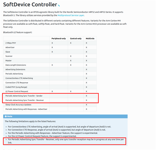

    NCS v2.2.0 did not include BT_CTLR_SYNC_TRANSFER_RECEIVER_SUPPORT in the Bluetooth controller (Zephyr or Softdevice). This is why the sample will only builds for simulation targets. I recommend you upgrade to v2.3.0 for now until v2.4.0 gets released.
    Softdevice controller features supported in NCS 2.3.0 - https://developer.nordicsemi.com/nRF_Connect_SDK/doc/2.3.0/nrfxlib/softdevice_controller/README.html
