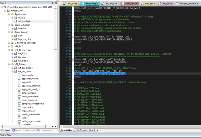

  • Dear Sigurd,
    I find how to used the pin1.01, I have just to change in the skd_config.h
    #define NRF_LOG_BACKEND_UART_TX_PIN 33
    UART pins are configured in the "nrfx_uarte.c" function, which uses the "apply_config(p_instance, p_config)" function.
