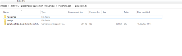

    But I'm still waiting for my JTAG adapter cable to arrive so I was attempting to program via USB following these instructions: https://developer.nordicsemi.com/nRF_Connect_SDK/doc/latest/nrf/working_with_nrf/nrf53/thingy53_gs.html
    But the sample that I compiled using the instructions from the previous step didn't generate any *.bin or *.zip files. So I used this documentation to try and trigger their generation in the build: https://developer.nordicsemi.com/nRF_Connect_SDK/doc/latest/nrf/app_dev/build_and_config_system/index.html#app-build-output-files
    Side note: I tried installing the SDK v2.3.0 through the toolchain manager originally but it wasn't fully installing. It didn't actually install of the necessary pieces but it says it was complete. I tried uninstalling and reinstalling twice and I only get a partial install each time with no errors.

    The first link regarding getting started with the Thingy:53 does only contain steps to use precompiled samples which does not require you to generate any builds. Could you verify if you were able to see the precompiled *.bins for the various samples in the zip in step 1-2 under "Updating through USB"?
    If you wish to generate your own builds, the best step is to go through section 1 of the Academy course you linked, and then open a sample through the toolchain manager
