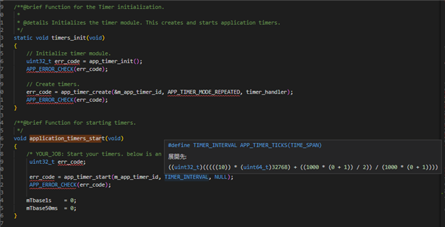

  • Thank you.
    I have added logging outputs to all handler functions, and except for the timer handler, they are not occurring frequently. Can application timer events, like the one attached, cause sleep disturbances?
  • I am not sure what you mean by a sleep disturbance, but every time an app_timer times out and runs, the CPU will wake up to process it (from an RTC interrupt). This is how it should be, though. As long as you call sd_app_evt_wait() in your main loop and don't do a lot of other stuff there, the CPU will go back to sleep again. This is how low-power applications are normally designed using the nRF5 SDK with SoftDevice.
