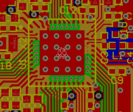

I have a question regarding the layout reference designs for the nRF52840. The traces on the top layer are running in parallel with the adjacent layer (2) for most of the fanout. I am concerned about coupling between the lines. What is the reason behind this design choice?
Thanks in advance.
    There might not be some special decision behind this particular design choice. In practice, you should not experience any problems related to the coupling.
