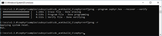

To test this behavior, I have compiled the zephyr/samples/subsys/usb/cdc_acm example for the nrf5340dk_nrf5340_cpuapp_ns board and fully erased and flashed it on my nRF5340-DK.

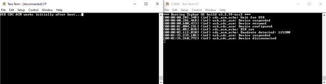

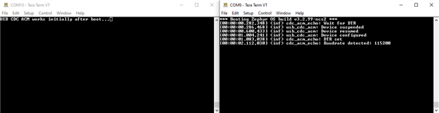

The USB device port does enumerate and work properly the first time it is plugged in. I get a virtual COM port and can open a terminal emulator and the USB console echoes each character I type. If I unplug the USB device port, wait a few seconds, and plug it back in, the device does not enumerate, and the previous virtual COM port is not present.

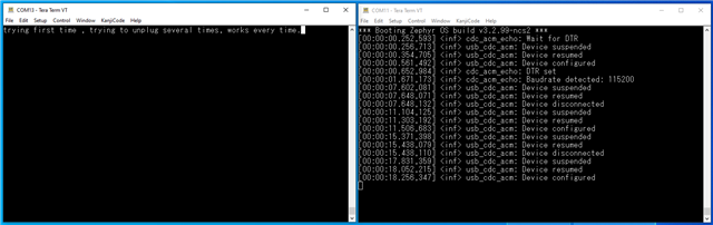

    Sorry for the time this is taking, before the developers can start to look into making a workaround they need to ensure the designers understand the root cause (it's only then they can be sure that any workaround will handle the issue). The issue have been recreated on actual boards, and next step is to recreate the issue by simulation (to find the root cause), simulation is a time consuming task both to setup but not least running the actual test in simulation (the entire chip is simulated so they need to simplify the software to for instance avoid any busy waits etc to reduce the simulation time). I expect simulations will be finished sometime next week, and I will update you when I learn more.
    Kenneth
  • Hello again,
    I can confirm they have been able to recreate the issue in simulation, so they understand more of what exactly is causing the issue, they are now looking into finding the least intrusive workaround. This will take some time, since workaround needs to be confirmed by actual test on the board but also simulations. I will update you when I know more.
    Kenneth
