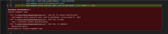

I try to configure it via the PC-BLE framework by using an nRF52840 dongle, but I get the error "Invalid argument type" every time when I want to schedule a write request:
What is wrong here and how can I fix this issue?

    The "Invalid argument type" issue comes from:
    self.adapter.write_req(self.conn, self.service, struct.pack('b', 20))
    I don't see where self.service comes from, though. Are parts of the script missing? The second parameter you pass to write_req() should be the UUID of the characteristic you are writing to.
