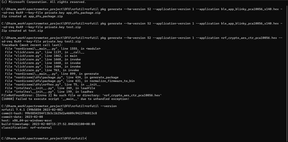

Hello ,
i am using nrfutil tool and generate zip file but i am getting error which is mention in picture. i try ble_app_blinky code and generated ZIP file successfully, can you tell me how to solve this error
i am using
1 ..nRF5SDK1500a53641a sdk
2.  nrfutil 7.4.1
3. windows 11 home
  • Hi DG,
    I see that you are using a nrfutil version newer than v7.0.0. In such versions, you need to enable support for nRF5 SDK first. Have you done that?
    If not, please follow the instruction in this page: https://infocenter.nordicsemi.com/topic/ug_nrfutil/UG/nrfutil/nrfutil_installing.html.
    Hieu

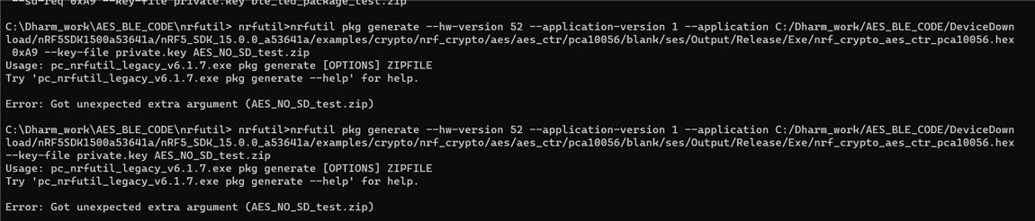

  • Hi Hieu

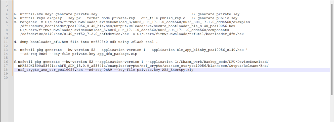

    i dump ble_led.zip file into nrf52840 using nrf connect tool .it is working fine but i generate AES_Encrypt.zip file and dump into nrf52840 sdk but it is not working. can you tell me why it is not working ? same normal_led.zip file not working
    1 . bootloader_dfu.hex file dump into nrf52840 sdk
    2 . nrfutil pkg generate --hw-version 52 --application-version 1 --application ble_app_blinky_pca10056_s140.hex --sd-req      0xA9 --key-file private.key ble_led.zip
    3. nrfutil pkg generate --hw-version 52 --application-version 1 --application              C:/Dharm_work/Backup_code/DFU/DeviceDownload/nRF5SDK1500a53641a/nRF5_SDK_15.0.0_a53641a/examples/crypto/nrf_crypto/aes/aes_ctr/pca10056/blank/ses/Output/Release/Exe/nrf_crypto_aes_ctr_pca10056.hex --sd-req 0xA9 --key-file private.key AES_Encrtpy.zip
     i generated zip file using  this commands and once try your side alse
    BR
    DG

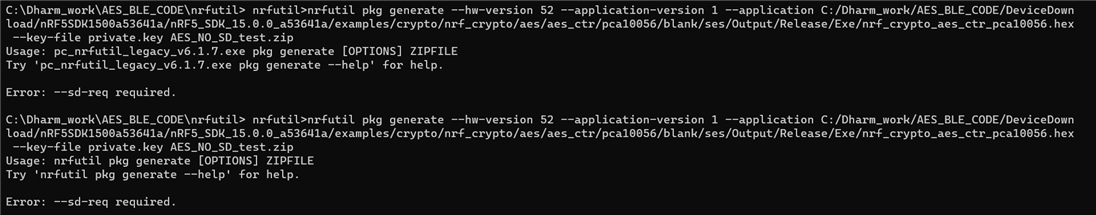

  • i removed --sd--req  from command then i got  some warning  pc_nrfutil_legacy_v6.1.7.exe pkg generate [OPTIONS] ZIPFILE and i download nrfutls version V6.1.7 and try but i still got error which is Error: --sd-req required..
    after install nrfutil version V6.1.7

  • DG, you might have misunderstood me. By
    Hieu said:
    You can remove the SoftDevice Requirement by removing the --sd-req parameters from the command.
    However, this recommendation from me is not correct. I reviewed your reply and see that you already flashed the SoftDevice onto the DK. I am sorry about this.
    I meant that --sd-req should not be removed.

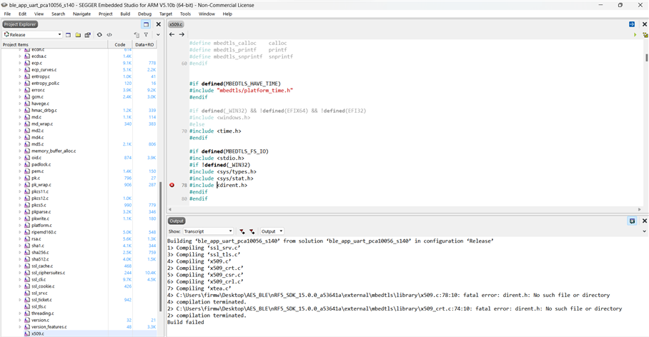

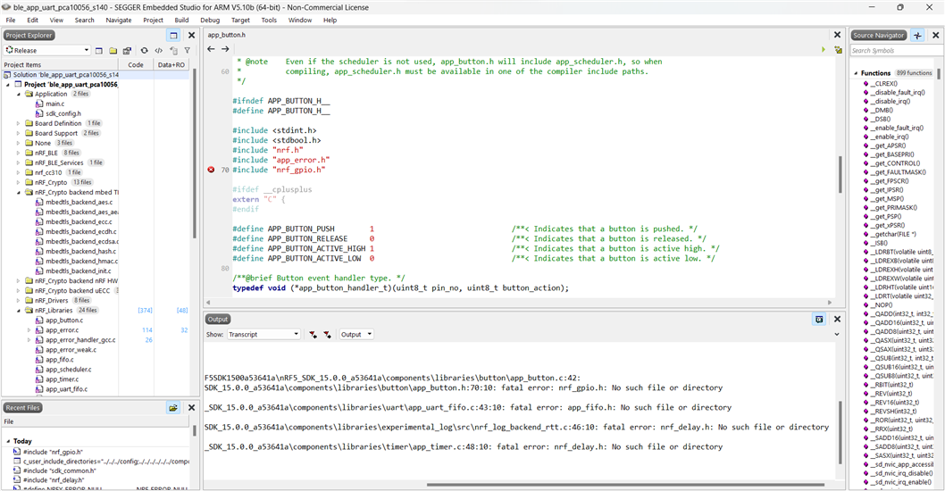

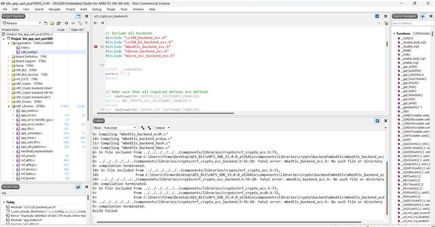

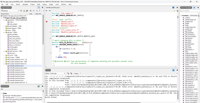

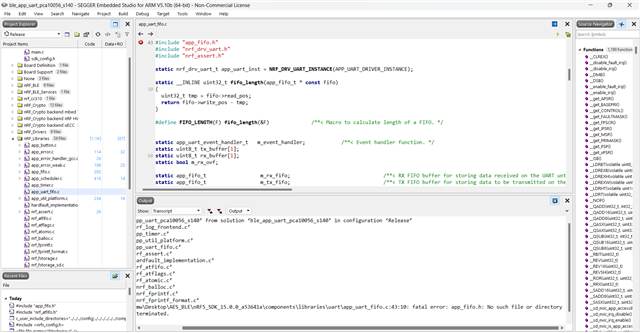

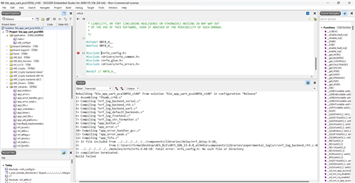

  • Hello Hieo,
    i am trying to combine ble_uart and AES_Ctr file but i am getting some error which in mention in
    picture ,can you tell me how to solve it.
    BR
    DG
  • Building ‘ble_app_uart_pca10056_s140’ from solution ‘ble_app_uart_pca10056_s140’ in configuration ‘Release’
    1> Compiling ‘nrf_log_backend_rtt.c’
    2> Compiling ‘nrf_log_backend_uart.c’
    3> Compiling ‘nrf_log_frontend.c’
    4> Compiling ‘nrf_log_default_backends.c’
    5> Compiling ‘nrf_log_str_formatter.c’
    6> Compiling ‘app_timer.c’
    7> Compiling ‘app_scheduler.c’
    8> Compiling ‘app_error_weak.c’
    9> Compiling ‘app_uart_fifo.c’
    10> Compiling ‘nrf_balloc.c’
    11> Compiling ‘nrf_atomic.c’
    12> Compiling ‘nrf_atfifo.c’
    1> C:\Users\firmw\Desktop\AES_BLE\nRF5_SDK_15.0.0_a53641a\components\libraries\experimental_log\src\nrf_log_backend_rtt.c:46:10: fatal error: nrf_delay.h: No such file or directory
    1> compilation terminated.
    9> C:\Users\firmw\Desktop\AES_BLE\nRF5_SDK_15.0.0_a53641a\components\libraries\uart\app_uart_fifo.c:43:10: fatal error: app_fifo.h: No such file or directory
    9> compilation terminated.
    2> C:\Users\firmw\Desktop\AES_BLE\nRF5_SDK_15.0.0_a53641a\components\libraries\experimental_log\src\nrf_log_backend_uart.c:45:10: fatal error: nrf_drv_uart.h: No such file or directory
    2> compilation terminated.
    6> C:\Users\firmw\Desktop\AES_BLE\nRF5_SDK_15.0.0_a53641a\components\libraries\timer\app_timer.c:48:10: fatal error: nrf_delay.h: No such file or directory
    6> compilation terminated.
    Build failed

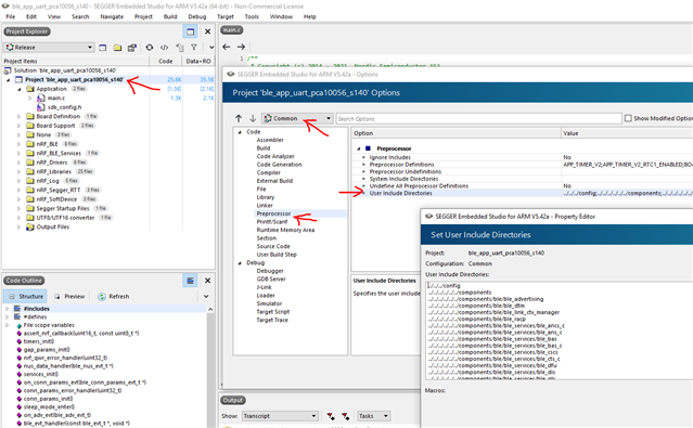

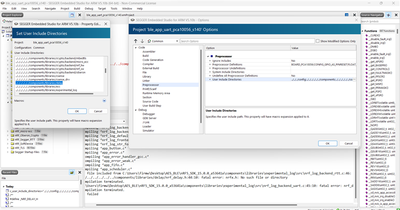

  • Hi DG,
    You will need to update the list of include directories. Please:
    1. Go into Project Options
      1. By right click on the Project in the Project Explorer window
      2. Or by using the menu Project > Options (remember to move up/down until the options is being displayed for the Project)
    2. Go to Code > Preprocessors > User include Directories
    3. Add the folders where the missing header files can be found to the list
  • Hi DG,

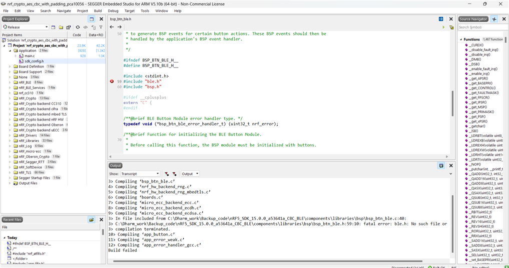

  • HI Hieu ,
    can you tell me what should add exactly .because i am adding path but still getting same error .i am sending you ble_uart and aes_ctr merge emproject file
    1> Assembling ‘thumb_crt0.s’
    2> Compiling ‘nrf_log_backend_serial.c’
    3> Compiling ‘nrf_log_backend_rtt.c’
    4> Compiling ‘nrf_log_backend_uart.c’
    5> Compiling ‘nrf_log_default_backends.c’
    6> Compiling ‘nrf_log_frontend.c’
    7> Compiling ‘nrf_log_str_formatter.c’
    8> Compiling ‘app_button.c’
    9> Compiling ‘app_error.c’
    10> Compiling ‘app_error_handler_gcc.c’
    11> Compiling ‘app_error_weak.c’
    12> Compiling ‘app_fifo.c’
    1> Compiling ‘app_scheduler.c’
    3> In file included from C:\Users\firmw\Desktop\AES_BLE\nRF5_SDK_15.0.0_a53641a\components\libraries\experimental_log\src\nrf_log_backend_rtt.c:46:
    3> ../../../../../../components/libraries/delay/nrf_delay.h:44:10: fatal error: nrfx.h: No such file or directory
    3> compilation terminated.
    4> C:\Users\firmw\Desktop\AES_BLE\nRF5_SDK_15.0.0_a53641a\components\libraries\experimental_log\src\nrf_log_backend_uart.c:45:10: fatal error: nrf_drv_uart.h: No such file or directory
    4> compilation terminated.
    Build failed

  • Hi DG,
    Please also add these include folders:
    ../../../../../../modules/nrfx for nrfx.h
    ../../../../../../integration/nrfx/legacy
    You might run into further missing include files as you proceed. Simply search for where those files are in the SDK, and provide a relative path to the file's containing folder.
    Also, if you are using the nRF5 SDK, please consider using the latest version, v17.1.0 instead.
    If you have strong reason to use v15.x.y, please consider using the latest version, v15.3.0.
    Otherwise, the nRF5 SDK is in maintenance mode, and we encourage all new projects to be based on the nRF Connect SDK.
  • Hi Hieu,
    now i am getting another error ,can you tell me what should add .and check this include directories
    c_user_include_directories="../../../config;../../../../../../components;../../../../../../components/ble/ble_advertising;../../../../../../components/ble/ble_dtm;../../../../../../components/ble/ble_link_ctx_manager;../../../../../../components/ble/ble_racp;../../../../../../components/ble/ble_services/ble_ancs_c;../../../../../../components/ble/ble_services/ble_ans_c;../../../../../../components/ble/ble_services/ble_bas;../../../../../../components/ble/ble_services/ble_bas_c;../../../../../../components/ble/ble_services/ble_cscs;../../../../../../components/ble/ble_services/ble_cts_c;../../../../../../components/ble/ble_services/ble_dfu;../../../../../../components/ble/ble_services/ble_dis;../../../../../../components/ble/ble_services/ble_gls;../../../../../../components/ble/ble_services/ble_hids;../../../../../../components/ble/ble_services/ble_hrs;../../../../../../components/ble/ble_services/ble_hrs_c;../../../../../../components/ble/ble_services/ble_hts;../../../../../../components/ble/ble_services/ble_ias;../../../../../../components/ble/ble_services/ble_ias_c;../../../../../../components/ble/ble_services/ble_lbs;../../../../../../components/ble/ble_services/ble_lbs_c;../../../../../../components/ble/ble_services/ble_lls;../../../../../../components/ble/ble_services/ble_nus;../../../../../../components/ble/ble_services/ble_nus_c;../../../../../../components/ble/ble_services/ble_rscs;../../../../../../components/ble/ble_services/ble_rscs_c;../../../../../../components/ble/ble_services/ble_tps;../../../../../../components/ble/common;../../../../../../components/ble/nrf_ble_gatt;../../../../../../components/ble/nrf_ble_qwr;../../../../../../components/ble/peer_manager;../../../../../../components/boards;../../../../../../components/drivers_nrf/usbd;../../../../../../components/libraries/atomic;../../../../../../../../components/libraries/atomic_fifo;../../../../../../components/libraries/atomic_flags;../../../../../../components/libraries/balloc;../../../../../../components/libraries/bootloader/ble_dfu;../../../../../../components/libraries/bsp;../../../../../../../../components/libraries/button;../../../../../../components/libraries/cli;../../../../../../components/libraries/crc16;../../../../../../components/libraries/crc32;../../../../../../components/libraries/crypto;../../../../../../components/libraries/crypto/backend/cc310;../../../../../../components/libraries/crypto/backend/cc310_bl;../../../../../../components/libraries/crypto/backend/cifra;../../../../../../components/libraries/crypto/backend/mbedtls;../../../../../../components/libraries/crypto/backend/micro_ecc;../../../../../../components/libraries/crypto/backend/nrf_hw;../../../../../../components/libraries/crypto/backend/nrf_sw;../../../../../../components/libraries/crypto/backend/oberon;../../../../../../components/libraries/csense;../../../../../../components/libraries/csense_drv;../../../../../../components/libraries/delay;../../../../../../components/libraries/ecc;../../../../../../components/libraries/experimental_log;../../../../../../components/libraries/experimental_log/src;../../../../../../components/libraries/experimental_memobj;../../../../../../components/libraries/experimental_mpu;../../../../../../components/libraries/experimental_ringbuf;../../../../../../components/libraries/experimental_section_vars;../../../../../../components/libraries/experimental_stack_guard;../../../../../../components/libraries/experimental_task_manager;../../../../../../components/libraries/fds;../../../../../../../../components/libraries/fifo;../../../../../../components/libraries/fstorage;../../../../../../components/libraries/gfx;../../../../../../../../components/libraries/gpiote;../../../../../../components/libraries/hardfault;../../../../../../components/libraries/hardfault/nrf52;../../../../../../components/libraries/hci;../../../../../../components/libraries/led_softblink;../../../../../../components/libraries/low_power_pwm;../../../../../../components/libraries/mem_manager;../../../../../../components/libraries/mutex;../../../../../../components/libraries/pwm;../../../../../../components/libraries/pwr_mgmt;../../../../../../components/libraries/queue;../../../../../../components/libraries/scheduler;../../../../../../components/libraries/stack_info;../../../../../../components/libraries/sdcard;../../../../../../components/libraries/slip;../../../../../../components/libraries/sortlist;../../../../../../components/libraries/spi_mngr;../../../../../../components/libraries/strerror;../../../../../../components/libraries/timer;../../../../../../components/libraries/twi_mngr;../../../../../../components/libraries/twi_sensor;../../../../../../../../components/libraries/uart;../../../../../../components/libraries/usbd;../../../../../../components/libraries/usbd/class/audio;../../../../../../components/libraries/usbd/class/cdc;../../../../../../components/libraries/usbd/class/cdc/acm;../../../../../../components/libraries/usbd/class/hid;../../../../../../components/libraries/usbd/class/hid/generic;../../../../../../components/libraries/usbd/class/hid/kbd;../../../../../../components/libraries/usbd/class/hid/mouse;../../../../../../components/libraries/usbd/class/msc;../../../../../../components/libraries/usbd/config;../../../../../../components/libraries/util;../../../../../../components/nfc/ndef/conn_hand_parser;../../../../../../components/nfc/ndef/conn_hand_parser/ac_rec_parser;../../../../../../components/nfc/ndef/conn_hand_parser/ble_oob_advdata_parser;../../../../../../components/nfc/ndef/conn_hand_parser/le_oob_rec_parser;../../../../../../components/nfc/ndef/connection_handover/ac_rec;../../../../../../components/nfc/ndef/connection_handover/ble_oob_advdata;../../../../../../components/nfc/ndef/connection_handover/ble_pair_lib;../../../../../../components/nfc/ndef/connection_handover/ble_pair_msg;../../../../../../components/nfc/ndef/connection_handover/common;../../../../../../components/nfc/ndef/connection_handover/ep_oob_rec;../../../../../../components/nfc/ndef/connection_handover/hs_rec;../../../../../../components/nfc/ndef/connection_handover/le_oob_rec;../../../../../../components/nfc/ndef/generic/message;../../../../../../components/nfc/ndef/generic/record;../../../../../../components/nfc/ndef/launchapp;../../../../../../components/nfc/ndef/parser/message;../../../../../../components/nfc/ndef/parser/record;../../../../../../components/nfc/ndef/text;../../../../../../components/nfc/ndef/uri;../../../../../../components/nfc/t2t_lib;../../../../../../components/nfc/t2t_lib/hal_t2t;../../../../../../components/nfc/t2t_parser;../../../../../../components/nfc/t4t_lib;../../../../../../components/nfc/t4t_lib/hal_t4t;../../../../../../components/nfc/t4t_parser/apdu;../../../../../../components/nfc/t4t_parser/cc_file;../../../../../../components/nfc/t4t_parser/hl_detection_procedure;../../../../../../components/nfc/t4t_parser/tlv;../../../../../../components/softdevice/common;../../../../../../components/softdevice/s140/headers;../../../../../../components/softdevice/s140/headers/nrf52;../../../../../../components/toolchain/cmsis/include;../../..;../../../../../../external/cifra_AES128-EAX;../../../../../../external/fprintf;../../../../../../external/mbedtls/include;../../../../../../external/micro-ecc/micro-ecc;../../../../../../external/nrf_cc310/include;../../../../../../external/nrf_oberon../../../../../../external/nrf_oberon/include;../../../../../../external/nrf_tls/mbedtls/nrf_crypto/config;../../../../../../external/segger_rtt;../../../../../../../../integration/nrfx;../../../../../../integration/nrfx/legacy;../../../../../../modules/nrfx;../../../../../../modules/nrfx/drivers/include;../../../../../../../../modules/nrfx/hal;../../../../../../modules/nrfx/mdk;../config"
  • Hi Hieu ,
    can you guide me how to solve these error. in which file
  • Hii Hieu,
    i am getting latest this error .can you guide me how to solve it .
    1> Compiling ‘nrf_drv_uart.c’
    2> Compiling ‘nrfx_clock.c’
    3> Compiling ‘nrfx_gpiote.c’
    4> Compiling ‘nrf_drv_clock.c’
    5> Compiling ‘nrfx_power_clock.c’
    6> Compiling ‘nrfx_uart.c’
    7> Compiling ‘nrfx_prs.c’
    8> Compiling ‘nrfx_uarte.c’
    9> Compiling ‘mbedtls_backend_aes.c’
    10> Compiling ‘mbedtls_backend_aes_aead.c’
    11> Compiling ‘mbedtls_backend_ecc.c’
    12> Compiling ‘mbedtls_backend_ecdh.c’
    9> C:\Users\firmw\Desktop\AES_BLE\nRF5_SDK_15.0.0_a53641a\components\libraries\crypto\backend\mbedtls\mbedtls_backend_aes.c:45:10: fatal error: mbedtls/md.h: No such file or directory
    11> In file included from ../../../../../../components/libraries/crypto/nrf_crypto_ecc.h:73,
    11> from C:\Users\firmw\Desktop\AES_BLE\nRF5_SDK_15.0.0_a53641a\components\libraries\crypto\backend\mbedtls\mbedtls_backend_ecc.c:49:
    11> ../../../../../../components/libraries/crypto/nrf_crypto_ecc_backend.h:56:10: fatal error: mbedtls_backend_ecc.h: No such file or directory
    11> compilation terminated.
    12> In file included from ../../../../../../components/libraries/crypto/nrf_crypto_ecc.h:73,
    12> from ../../../../../../components/libraries/crypto/nrf_crypto_ecdh.h:72,
    12> from C:\Users\firmw\Desktop\AES_BLE\nRF5_SDK_15.0.0_a53641a\components\libraries\crypto\backend\mbedtls\mbedtls_backend_ecdh.c:50:
    12> ../../../../../../components/libraries/crypto/nrf_crypto_ecc_backend.h:56:10: fatal error: mbedtls_backend_ecc.h: No such file or directory
    12> compilation terminated.
    10> In file included from C:\Users\firmw\Desktop\AES_BLE\nRF5_SDK_15.0.0_a53641a\components\libraries\crypto\backend\mbedtls\mbedtls_backend_aes_aead.c:46:
    10> C:\Users\firmw\Desktop\AES_BLE\nRF5_SDK_15.0.0_a53641a\components\libraries\crypto\backend\mbedtls\mbedtls_backend_aes_aead.h:57:10: fatal error: mbedtls/ccm.h: No such file or directory
    10> compilation terminated.
    Build failed
