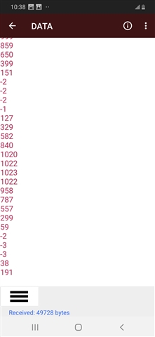

Problem: I face an issue of missing ADC data on the mobile App side when I am trying to send 96 samples in a Bluetooth packet (96 samples are converted to 192 bytes, as each sample is 2 bytes). When I send 48 samples (96 bytes) in a Bluetooth packet, I still have some data missed on the Mobile App side but, the problem is not severe in that case. When ADC data checked without combining the BLE part, they look fine.

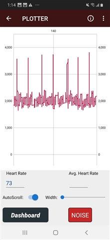

    Moreover, I think I need to describe a bit about our custom Android App. In the Android App, we are converting and combining the hex (sent from the device) to form the same values we get from the SAADC. We have considered the concept that SAADC is filling the buffer in 2's complement form while building the App. I have added 2 snapshots of the App where, i) we can see the value we are getting through BLE and ii) we can see the plotting of a real time ECG (from this view, it seems like we are missing some ADC samples)
    i)                                                   ii)
    Also, I think it will be convenient if I share the project here. At this point, the code may look little bit messy. Please pardon me for that. I will clean them up and add few more things at later stages. I am using SDK V17.0.2 and nRF 52840 DevKit. The project is as follows:

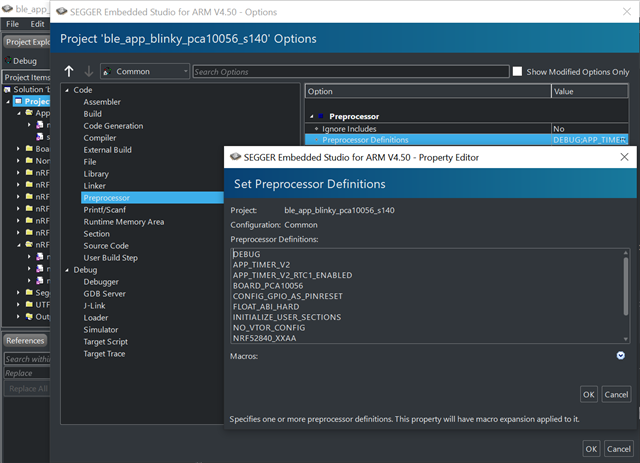

    Please make sure that you have added the DEBUG define to your preprocessor definitions like shown in the picture, to have the logger module output a detailed error message whenever a non-NRF_SUCCESS error code is passed to an APP_ERROR_CHECK: This makes it much easier to check the meaning of the error codes against the returning functions API reference.

    What do you mean you had to remove the APP_ERROR_CHECK to see these errors?
    With the APP_ERROR_CHECK I was stuck at ble_nus_data_send. That's why I removed this line to check further. But, I understand we need this to avoid any potential problem through out the development. I will put it back in the code Slight smile.
