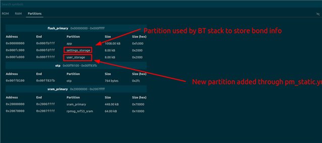

    user_storage:
    address: 0xfa000
    end_address:0xfc000
    placement:
    before:
    - settings_storage
    region: flash_primary
    settings_storage:
    address: 0xfc000
    end_address: 0x100000
    placement:
    before:
    - end

    I still get an error:
    'PM_PM_PM_user_storage_ID_LABEL_OFFSET' undeclared (first use in this function)

    For anyone else who is going to pick up this thread, I made some more changes and feel I am getting a bit closer, but….
    So here’s my update for now:
    I removed the following two settings from the prj.conf, and confirmed that CONFIG_PARTITION_MANAGER_ENABLED is still set, via some other configuration flag as you suggested:
    #CONFIG_PARTITION_MANAGER_ENABLED=y
    #CONFIG_SETTINGS_NVS_SECTOR_COUNT=6
    I moved the pm_static.yml to the source directory, and modified the contents, which are now:
    storage:
      address: 0xfa000
      end_address: 0xfe000
      placement:
      before:
      - user_storage
    user_storage:
      address: 0xfe000
      placement:
      before:
      - end

  • Hi Garret,
    I will try to follow up here while Hieu is out of the office. I'm not sure why the program fails to return from your nvs_mount() call. But are you still on SDK v2.1.0?  prepared a new test example based on the peripheral_lbs sample and the code snippets you posted here, and it would be great if you could try running this on your end to see if it works for you as well.
    I didn't make much changes to the project. Here is a 'diff' of the changes I made to main.c:
    diff --git a/src/main.c b/src/main.c
    index 7483c69..163a979 100644
    --- a/src/main.c
    +++ b/src/main.c
    @@ -181,6 +181,77 @@ static int init_button(void)
     	return err;
    +#include <zephyr/drivers/flash.h>
    +#include <zephyr/storage/flash_map.h>
    +#include <zephyr/fs/nvs.h>
    +static struct nvs_fs fs;
    +#define RBT_CNT_ID 3
    +#define STORAGE_NODE_LABEL	user_storage
    +int my_file_init()
    +	int rc;
    +	struct flash_pages_info info;
    +	uint32_t reboot_counter = 0U;
    +	/* define the nvs file system by settings with:
    +	 *	sector_size equal to the pagesize,
    +	 *	2 sectors
    +	 *	starting at FLASH_AREA_OFFSET(STORAGE_NODE_LABEL)
    +	fs.flash_device = FLASH_AREA_DEVICE(STORAGE_NODE_LABEL);
    +	if (!device_is_ready(fs.flash_device)) {
    +		return -1;
    +	fs.offset = FLASH_AREA_OFFSET(STORAGE_NODE_LABEL);
    +	rc = flash_get_page_info_by_offs(fs.flash_device, fs.offset, &info);
    +	if (rc) {
    +		return -2;
    +	fs.sector_size = info.size;
    +	/* Allocate the whole partition to nvs */
    +	fs.sector_count = FLASH_AREA_SIZE(STORAGE_NODE_LABEL) / info.size ;
    +	rc = nvs_mount(&fs);
    +	if (rc) {
    +		return -3;
    +	printk("*** %s partition mounted *** \n", STRINGIFY(STORAGE_NODE_LABEL));
    +	printk("Start address: 0x%x\n", (uint32_t) info.start_offset);
    +	printk("Sectors: %d\n", fs.sector_count);
    +	/* RBT_CNT_ID is used to store the reboot counter, lets see
    +	 * if we can read it from flash
    +	rc = nvs_read(&fs, RBT_CNT_ID, &reboot_counter, sizeof(reboot_counter));
    +	if (rc > 0) { /* item was found, show it */
    +		reboot_counter++;
    +		(void)nvs_write(&fs, RBT_CNT_ID, &reboot_counter,
    +			  sizeof(reboot_counter));
    +		printk("Id: %d, Reboot_counter: %d\n",
    +			RBT_CNT_ID, reboot_counter);
    +	} else   {/* item was not found, add it */
    +		printk("No Reboot counter found, adding it at id %d\n",
    +		       RBT_CNT_ID);
    +	return 0;
     void main(void)
     	int blink_status = 0;
    @@ -241,6 +312,8 @@ void main(void)
     	printk("Advertising successfully started\n");
    +	my_file_init();
     	for (;;) {
     		dk_set_led(RUN_STATUS_LED, (++blink_status) % 2);
     		k_sleep(K_MSEC(RUN_LED_BLINK_INTERVAL));
    I also added this 'pm_static.yml' file to allocate the 'user_storage' partition:
    user_storage:
      address: 0xfe000
      placement:
      before:
      - end
    Generated Memory report
    Note: the DTS partitions are ignored when the partition manager is enabled, which is true for any multi-image builds.
    peripheral_lbs_nvs_user_storage.zip

  • Hi Vidar
    You inadvertently solved my problem.
    In my existing project, I modified the pm_static.yml from:
    storage:
      address: 0xfa000
      placement:
      before:
      - storage
    user_storage:
      address: 0xfe000
      placement:
      before:
      - end
    to this:
    user_storage:
      address: 0xfe000
      placement:
      before:
      - end
    And everything worked :)
    So the issue was that I must have been messing up the existing ‘storage’ allocation/definition, and once I removed it from the .yml file, it must be happy with what ever default settings it has from elsewhere.
