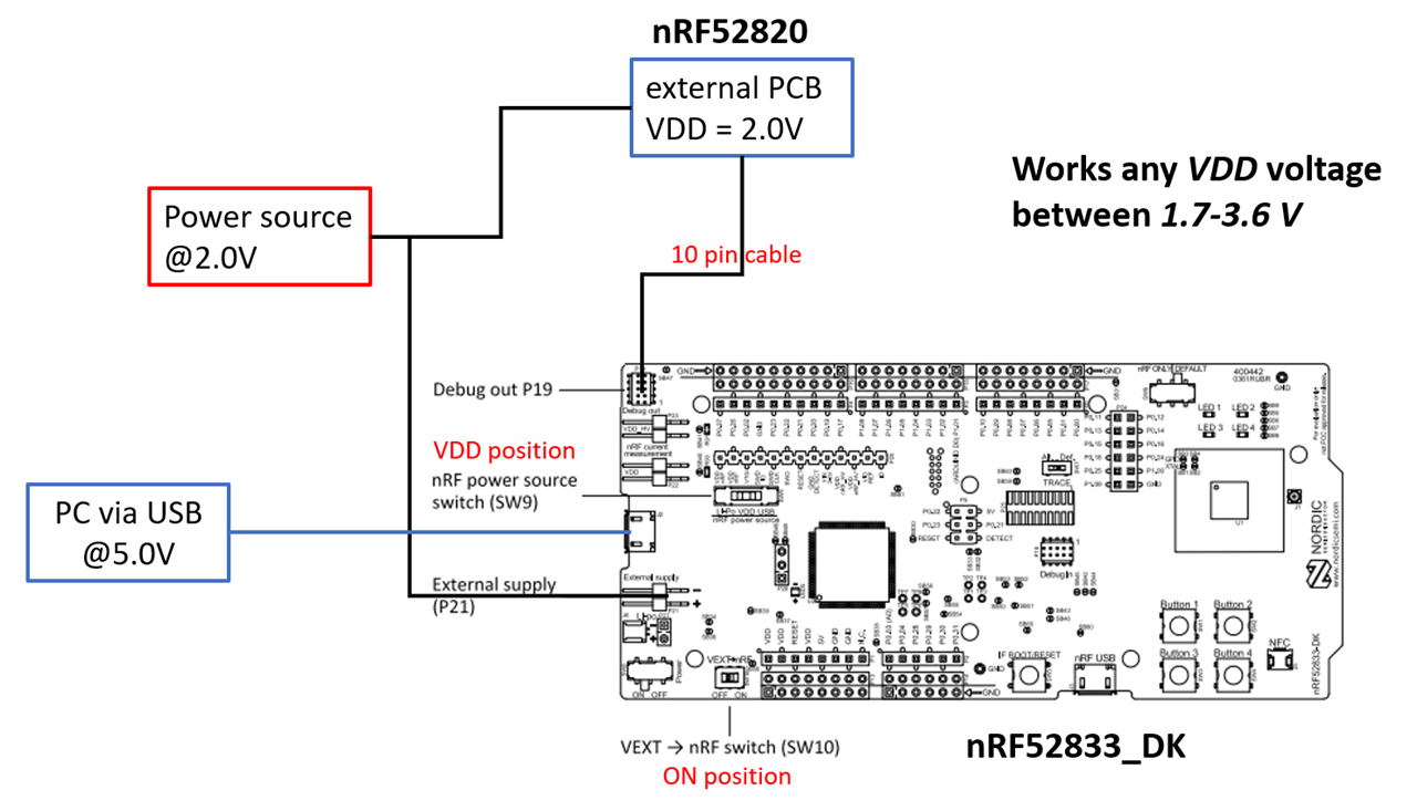

I'm just about to flash an external board (nRF52820) through P19 where the MCU is powered at 2.3V. I would like to use the nRF52833_DK and the PPK2 to do the flashing and I was wondering what would be the best power source configuration on the DK side to do the flashing? How could I bring the VDD level down to 2.3V on the DK side?
Would powering the DK SoC via P21 (@2.3V) and rest of the DK board via USB and switching the SW10 to "ON" be ok for flashing?
