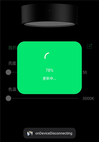

OTA-DFU fail by Android mobile, when device and mobile distance over 80cm..
Dear:
 I had production a device, using:
  nRF51822 + SDK12.3S130 + Bootloader
For update Application packaged code(zip) by OTA-DFU
1. at iOS, we can update code.
2. at Android, Mobile must be close to the device to succeed
Why do Android phones have to be closer to the device(less then 80cm) to complete it, but iOS doesn't?
that distance is too small for user.
Is there any setting that I have overlooked or is there any reference setting in the API program?
Addriod API had insert DFU_Library 1.1.1(Maven Repository: no.nordicsemi.android » dfu » 1.1.1 (mvnrepository.com))

  • I had using sniffer trace, get CRC Error.
    The CRC Error occurs when data is transmitted in OTA-DFU mode.
    and that is using   RedMi 10 & Galaxy A13 with same problem
    But Google Pixel 4 XLgalaxy tab s8 can pass the OTA-DFU
    I have no idea how to fix it. I can't require all customers to use iphone.

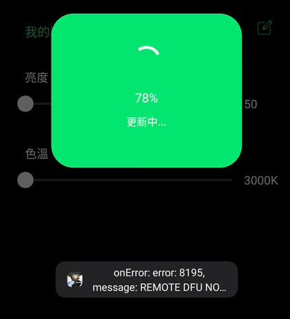

  • Hi, Hung:
    The OTA-DFU package file with private.key, Can I using Sniffer trace it?
    and I had request API whit nRF-Logger-API
    Some messages pop up on the screen, what APP (nRF Logger?) should I install on my phone to get detailed log information?
