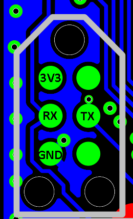

    I'm trying to use SDK v.2.3.0 nrf/samples/bluetooth/direct_test_mode with built-in USB on nRF5340 or the UART-to-USB virtual COM port with an FTDI cable that has a TC2030 connector on the end, but that hasn't worked.
    The TC2030 connector looks like this on our PCB:
     TC2030-MCP-NL.pdf
    Based on this document DTM for DUT
    Our UART_DBG_TX pin is P0.28 and the UART_DBG_RX pin is P0.27. Do I need to edit the nrf5340dk_nrf5340_cpunet-pinctrl.dtsi file like so?
    And do I add CONFIG_DTM_USB=y to my prj.conf file without adding any files like zephyr/drivers/usbc.h or other code to use DTM on my custom board via USB? I also added CONFIG_CLOCK_CONTROL_NRF_K32SRC_RC=y to the prj.conf file since we don't have an external 32KHz oscillator between X1 and X2. Is there anything else I need to do to make the nRF Connect DTM app on my Windows 10 PC work with my custom board?
    The reason I ask is because the attached DK hex files you provided didn't automatically work with my custom board.
    Yes, this should work. However, the recommended approach is to create a board overlay in your project directory. This way you won't have to edit the original board files. There is already an overlay present overlay for the remote_shell application in the project directory here /direct_test_mode/child_image/remote_shell/boards/nrf5340dk_nrf5340_cpuapp.overlay which you can use.
