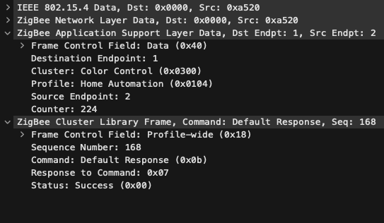

    This is what the payload of the packet looked like:
    As you can see from the log, zcl_device_cb was called for both endpoints:

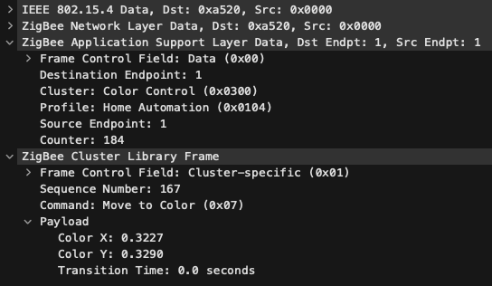

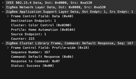

  • Thanks to your help I was able to debug it further. When I send a single "move to color" command at either endpoint, everything works as expected. So I have the same behaviour as you. However if I send two commands in a very short amount of time, then only the second command will be relayed to zcl_device_cb. Important note: the color for the first endpoint is different from the command before.
    The commands that are being sent:
    The first and the second "move to color" command in detail:
    The first and second response:

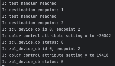

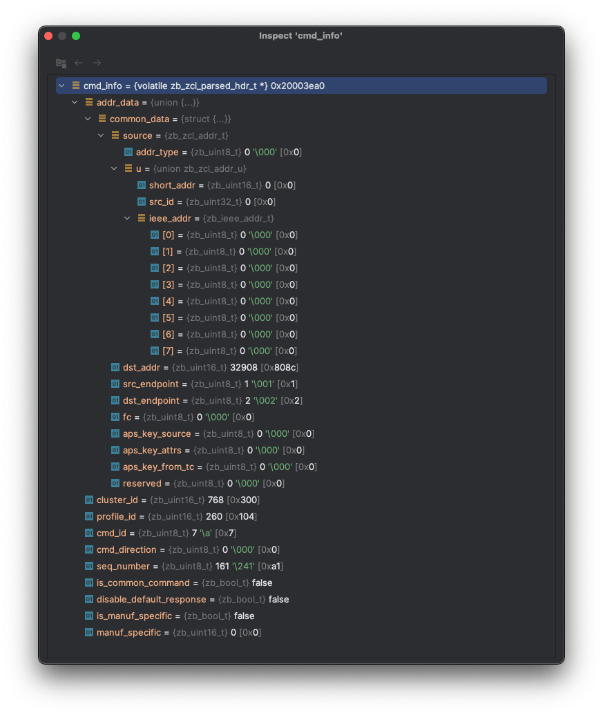

    Moreover I did implement a test handler for both endpoints with:
    ZB_AF_SET_ENDPOINT_HANDLER(DIMMABLE_LIGHT_ENDPOINT, test_handler);
    ZB_AF_SET_ENDPOINT_HANDLER(DIMMABLE_LIGHT_ENDPOINT_2, test_handler);
    and
    zb_uint8_t test_handler(zb_uint8_t param) {
        LOG_INF("test handler reached");
        zb_bufid_t zcl_cmd_buf = param;
        volatile zb_zcl_parsed_hdr_t *cmd_info = ZB_BUF_GET_PARAM(zcl_cmd_buf, zb_zcl_parsed_hdr_t);
        LOG_INF("destination endpoint: %d", cmd_info->addr_data.common_data.dst_endpoint);
        return 0;
    Now I can see that when I send two endpoints in a short sequence my test_handler gets called two times, one for each endpoint. However, only the second command also gets relayed to the default handler as well. The package that does not get relayed can be seen in the original post.
