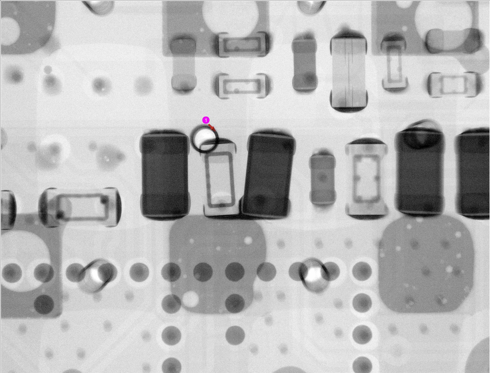

Hello! I found on the X-Ray picture from NRF9160-SICA-B1A-R7 some parts which are looking unusual inside. Does it causes any functional disorder or is it normal?
Thank you for your comment.
These two components are connected by design, therefore cause no issue in the functionality of the device.
