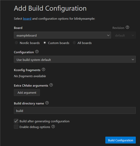

Build own custom board on nrf Connect SDK(Devicetree)
hello i have created my own devicetree (.dts) file for a self developed board(nrf52dk_nrf52832_customer) based on the nrf52 chip. So I created an folder( named: nrf52dk_nrf52832_customer)  at the following file path:
 ncs\v2.3.0\zephyr\boards\arm\nrf52dk_nrf52832_customer.
he devicetree can be found at this file path:
How can I now flash an application on the customer board. In Visual Studio Code the board does not appear (see picture), So I can not build the whole thing.
Parents Reply
  • Ok, now I create a board like you described earlier. But I only add the changed  dts file and dtsi file to the project(application) folder and I build the application with the nordic board nrf52832DK (from nrf Connect SDK). it works this way. But my question is: the dts and dtsi files from the nrf5832dk will be overwritten with the dts and dtsi files in the project (application folder)?
    and I also ttry to create a custom board like you described it earlier. But I dont change any file in the custom board and it also works this way
