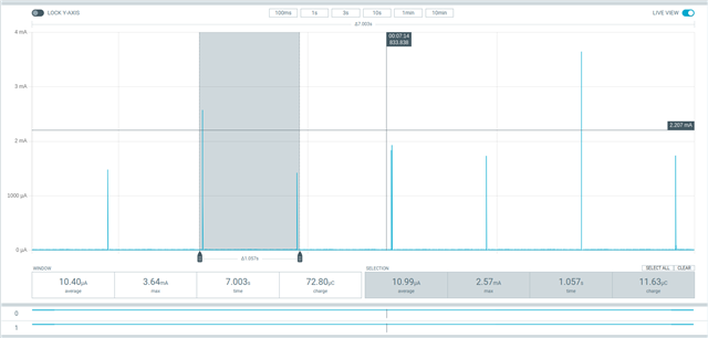

    And here's the power consumption:
    pzuck said:
    Indeed, when I cut the power to the sensor, it remains powered from /CSN, until I set /CSN to low.
    This is as intended. If you are powering off your external sensor, you need to ensure that all GPIOs/signals going to your external sensor are kept at GND level.
    Håkon

    The idle level of /CSN is high. If you power off your external sensor, you need to set that pin low to ensure that you're not back-powering your external sensor.
    Here's a way to set/clr the GPIO:
    #include <hal/nrf_gpio.h>
    nrf_gpio_pin_clear(DT_SPI_DEV_CS_GPIOS_PIN(DT_NODELABEL(spi0_cs)));
    pm_device_action_run(spi_dev, PM_DEVICE_ACTION_SUSPEND);
    nrf_gpio_pin_set(DT_SPI_DEV_CS_GPIOS_PIN(DT_NODELABEL(spi0_cs)));
    pm_device_action_run(spi_dev, PM_DEVICE_ACTION_RESUME);
    Håkon
