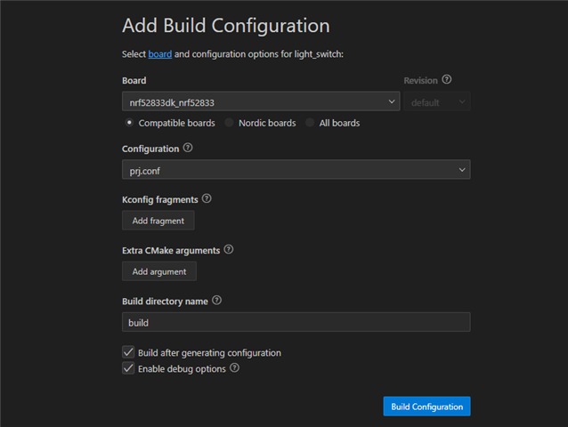

I am attempting to build the Zigbee Light Switch sample on my nRF52833 DK, but the sample is generating an error every time I am attempting to build it. I have tried various combinations of settings in the build configurations but there always seems to be some error. I am attaching a file showing the terminal output (using the integrated terminal in the nRF for VSCode extension) while building and a screenshot of my build configuration in VSCode.
I would greatly appreciate some help in this matter, thank you!

    1. I did not change anything in the nrf52833dk-nrf52833.conf file either, and I just checked and saw that CONFIG_CRYPTO is set to 'y'.
    Hmm, interesting. Are you able to compile any other zigbee samples? How about any other non-zigbee samples, for instance the hello world sample?
    I do also see that the path used in the build log is '"c:\Users\nandi\Desktop\nrfProject\light_switch\build_1", do you know if this is outside of where you've installed the SDK?  The issue might be path related so could you try to compile a sample from the SDK? Use the "Open existing application", navigate to the Zigbee sample located in <ncs install location\v.2.4.0\nrf\samples\zigbee\zigbee_light_switch and build for nrf52833dk_nrf52833 or through commandline, whichever you prefer

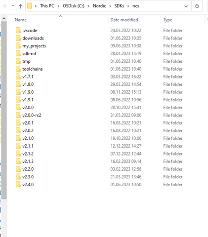

    This is not necessary the best solution, but one suggestion is to use a similar setup as mine
    I have every version that I need to use installed in one location. Every v.x.x.x is one instance of the SDK that I have kept relatively pristine.

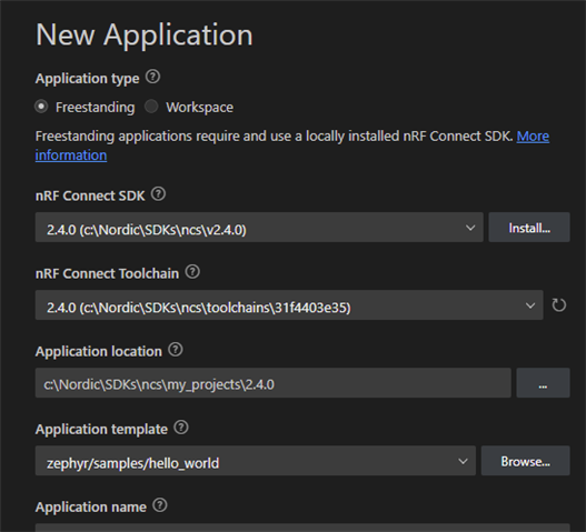

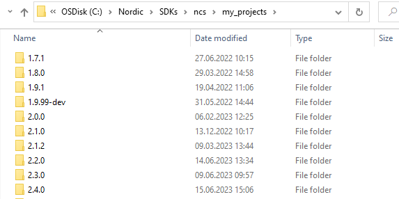

    In my_projects I have the different projects that I have created by using "create new application from existing sample" and setting the Application location to a respective folder in my_projects.
    This way I can keep the samples as pristine as possible and modify them as I need outside of the SDK
