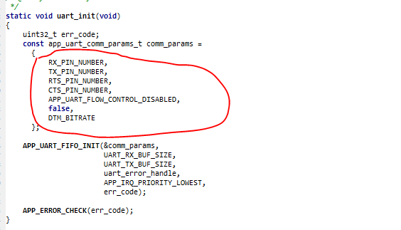

And then, I modified the nRF5_SDK_17.1.0_ddde560\examples\dtm\direct_test_mode/main.c
But, it is not working with nRF Connect for desktop/Direct Test Mode.
I find " Can not communicate with my custom device." error.
And, I modify TX/RX port in main.c of dtm example to as follow
P0.05 RTS
P0.06 TXD
P0.07 CTS
P0.08 RXD
And compile and upload to nrf52840 DK board.

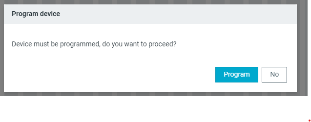

But, Direct test Mode appl do upgrade nrf52840 DK board firmware to some binary(maybe pre-compiled version by Nordic)
And DTM test is success by your binary.
Wha problem in my product?

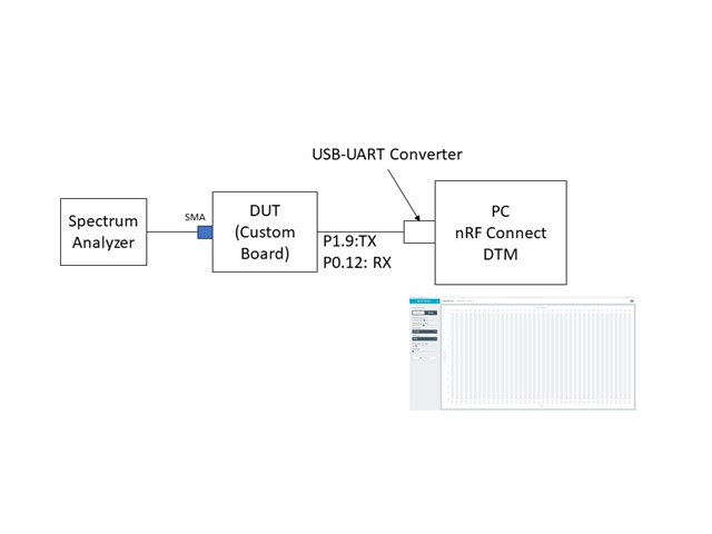

    I want to do DTM test  for my custom board by nRF Connect DTM directly. not thru DK board.
    This is my history to test
    1. I have modified example source code of UART, and compile and upload to my custom board.
    2. but nRF Connect DTM app did not recognize my custom board. I found "Communication Error"
    3. So, I made this ticket. "nRF52840 DTM Can not communicate with my custom device."
    4. To  exclude my custom board's H/W problem, I wanted to test DK board first.
    5. After compile example WITHOUT any modify and upload to DK board, but nRF Connect DTM can not recognize uploaded F/W on DK board as I mentioned before.
    I want to test my custom board by nRF Connect DTM directly thru USB UART.
    BR
    Paul

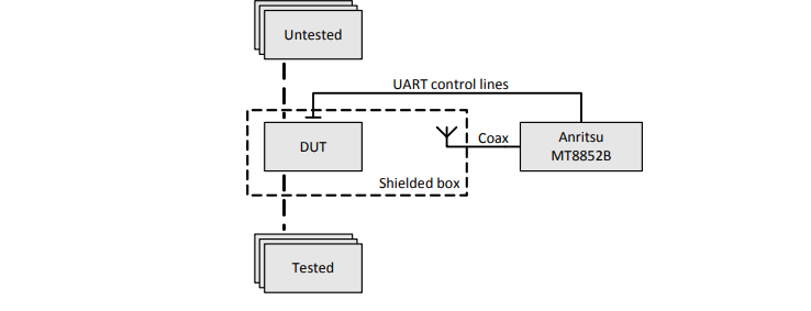

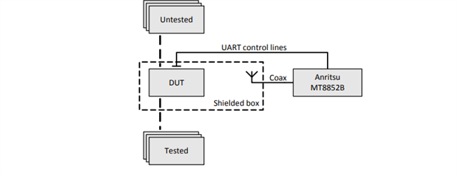

    This is not supported, you either have to use a DK or a Anritsu as a production tester. This is described in the app note I shared earlier:

    DUT has UART interface connected to PC or Anritus as Fig 2 you attached.
    And dtm example should be programed into DUT after modifying UART configuration.
    This dtm example is not interworking with nRF connect DTM directly?
    Computer in Fig 2 is not nRF connect DTM?
    BR
    Paul
