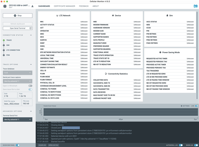

I'm using the "Cellular Monitor v1.0.2" to collect modem traces from a custom board on a non Zephyr based eco system for the nRF9160 - we use FreeRTOS. As a consequence our normal uart text log output does not follow any convention Zephyr did introduce, e.g. AT command responses etc.
Question 1:
Are the displayed information field "LTE Network", "Device", "SIM" etc. sourced from the actual modem trace? Or are these information displays sourced from parsing the "normal" non trace log of the device in question? I'm asking since these fields are not populated in my tests but a modem trace is written.

    Question 1:
    I believe it is taken from the trace, but I need to double check this with the developers.

  • Are the displayed information field "LTE Network", "Device", "SIM" etc. sourced from the actual modem trace?
    The developers confirm that the information is taken from the modem trace.
