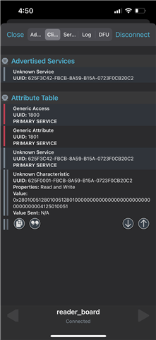

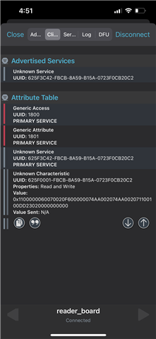

    After changing the declaration to:
    int test[8] = {0x11, 0x22, 0x33, 0x44, 0x55, 0x66, 0x77, 0x88};
    I still got really odd results on the phone (first picture).

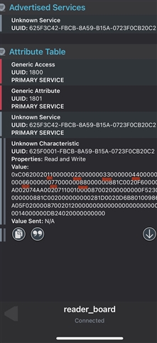

    I then realized that maybe my "int" type was being stored as a 32 bit type or something since there seemed to be correct data every 4 bytes in the app! So I tried declaring the array as the following:
    uint8_t test[8] = {0x11, 0x22, 0x33, 0x44, 0x55, 0x66, 0x77, 0x88}; //changed to uint8_t type. This way there's no extra data in between.

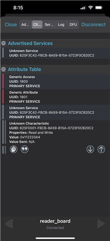

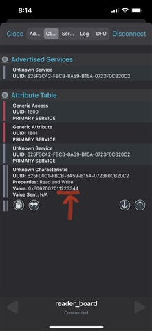

    This looked better (second picture), however I still had some odd data right at the start. I figured this had to do with the data length and offset that I was passing in so I fiddled with those for a while and I figured out that if I set the offset to 4 then I can put my data right at the beginning. However, half of the data gets chopped off! (third picture). So I added the offset back onto the length argument of bt_gatt_attr_read() so my code looked like this:
    static ssize_t BT_transaction_read_cb(struct bt_conn *conn, const struct bt_gatt_attr *attr, void *buf, uint16_t len, uint16_t offset) {
        mainboard_uart_send("bt_read!\r\n", 10);
        int *p_test = test;
        offset = 4;
        return bt_gatt_attr_read(conn, attr, buf, len, offset, &p_test, sizeof(uint8_t)*sizeof(test) + offset);
    This resulted in a correct looking output (picture 4). I just don't know if I'm supposed to be messing with the offset variable, or if there is a more elegant way to do this etc.
    Picture 1: Output with integer array
    Picture 2: Output with uint8_t array
    Picture 3: Output with uint8_t array with the offset forcibly set to 4
    Picture 4: Output with uint8_t array, offset set to 4, offset added onto length argument of bt_gatt_attr_read().

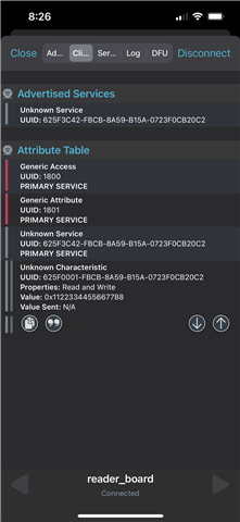

    1. If you're getting compiler warnings you need to handle that, they exist for good reason.
      You are probably getting a warning saying that you have an implicit pointer type conversion when you point p_test of type int to a uint8_t without a cast.
    2. You don't need the p_test pointer at all as an array is already a pointer in C, where a given array index is accessed by taking the address of test[0] and adding the index multiplied by the size of the array's type. For a uint8_t array this means that to access test[2] the compiler takes the address of test[0] and adds 2 * sizeof(uint8_t).
    3. You don't need multiply sizeof(uint8_t) with sizeof(test). Sizeof() gets evaluated at compile-time where both the type and length of the array is known. Sizeof(test) will therefore return 8.
    Try this:
        return bt_gatt_attr_read(conn, attr, buf, len, offset, test[0], sizeof(test));
  • Thank you! +1 vote up for the code snippet.
    The problem indeed lied with how I was passing the array into the function. By removing the ampersand from the argument I was able to get it to work. Thank you for the tip about not needing an additional pointer.
  • About the pointer.
    You passed the address of the pointer instead of its content to bt_gatt_attr_read().
    I think that since both the array and the pointer can be considered as constant expressions(share memory allocation type), and because they were decleared one after the other in within the sample compilation unit(source file), their memory allocation was placed next to each other.
    I think the pointer was allocated to memory first, because the size of a pointer is always equal to the addressable range of a given architecture, in this case 32-bits or 4 bytes, and you needed to add an offset of 4 bytes in order to read from test[0] to test[7].
