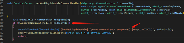

matter lock development: featureMAP is not in effect
procedure:
1. Modify lock.zap, turn on related functions, and set featureMAP from the default value of 0x101 to 0xf3d
2.Generate source code with zap tool
3. Set user (weeklyDay scheduled  user):./chip-tool-debug doorlock set-user 0 2 username2 124 1 2 0 140 1 --timedInteractionTimeoutMs 2000
4、set weeklyDay scheduled:./chip-tool-debug doorlock set-week-day-schedule 1 2 0xff 0 0 22 59 140 1
Error occurred: The command to set the weekly schedule was ignored because the feature did not take effect
log1:
[SetWeekDaySchedule] Ignore command (not supported) [endpointId=1]
log2:
[ZCL][GetWeekDaySchedule] Ignore command (not supported) [endpointId=1]
Error source location, tracking down shows that the feature is not, but I actually enabled in the zap file:
Attach the zap file, and the generated source code:
