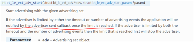

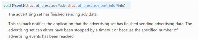

    2)
    You get the on_sent callback when either timeout occurs, or the number of advertising events specified have occurred. If both are set to 0, you don't get any callback. Advertising stops when either occurs.
    https://docs.zephyrproject.org/latest/connectivity/bluetooth/api/gap.html#c.bt_le_ext_adv_cb.sent
    https://docs.zephyrproject.org/latest/connectivity/bluetooth/api/gap.html#c.bt_le_ext_adv_start

  • Thank you Sigurd,
    adding the
    BT_LE_ADV_OPT_NOTIFY_SCAN_REQ
    flag solved the issue. Also setting .num_events > 0 in the
    bt_le_ext_adv_start_param
    struct causes .sent to be triggered.
