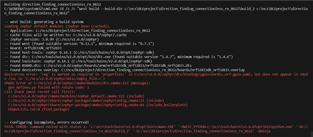

nRF52833 has an error in building/flash (direction finding connectionless rx)
i used 52833 prgramming the sample in VS code(DF coneectionless RX) , it was ok few days ago.
but now, it has fatal error when it builds or flash in board.
i didnot change much content. i tried fixed it , I have confirmed some files exists in the path.
i want to know what happened and how to fix.
IDE version:
WIN10
nRF Connect for Desktop v4.0.1
toolchain manager v1.2.0
nrf connect SDK v2.0.0
zephyr sample direction finding connectionless rx
zephyr sdk 3.0.99
some happen
or
    Have you tried completely deleting the build folder before rebuilding?
    Could I see the prj.conf and any overlays in the project? Which files did you make changes in?
  • I have completely deleted the build folder before rebuilding ,but it still has fatal error
    i remember that i don't change the configure.
    prj.conf

    the complete error message
    Building direction_finding_connectionless_rx_0616
    C:\WINDOWS\system32\cmd.exe /d /s /c "west build --build-dir c:\direction_finding_connectionless_rx_0616\build c:\direction_finding_connectionless_rx_0616 --pristine --board nrf52833dk_nrf52833 -- -DNCS_TOOLCHAIN_VERSION:STRING="NONE" -DBOARD_ROOT:STRING="c:/direction_finding_connectionless_tx_AudenTEST;c:/direction_finding_connectionless_tx_0524;c:/direction_finding_connectionless_rx_0616" -DCONFIG_DEBUG_OPTIMIZATIONS:STRING="y" -DCONFIG_DEBUG_THREAD_INFO:STRING="y" -DDTC_OVERLAY_FILE:STRING="c:/direction_finding_connectionless_rx_0616/boards/nrf52833dk_nrf52833.overlay" -DCONF_FILE:STRING="c:/direction_finding_connectionless_rx_0616/prj.conf;c:/direction_finding_connectionless_rx_0616/boards/nrf52833dk_nrf52833.conf""
    -- Application: C:/direction_finding_connectionless_rx_0616

    [60/224] Building C object CMakeFiles/app.dir/src/main.c.obj
    FAILED: CMakeFiles/app.dir/src/main.c.obj
    C:\ncs\toolchains\v2.0.0\opt\zephyr-sdk\arm-zephyr-eabi\bin\arm-zephyr-eabi-gcc.exe -DKERNEL -DNRF52833_XXAA -DUSE_PARTITION_MANAGER=0 -D_FORTIFY_SOURCE=2 -D__PROGRAM_START -D__ZEPHYR__=1 -IC:/ncs/v2.0.0/zephyr/include/zephyr -IC:/ncs/v2.0.0/zephyr/include -Izephyr/include/generated -IC:/ncs/v2.0.0/zephyr/soc/arm/nordic_nrf/nrf52 -IC:/ncs/v2.0.0/zephyr/soc/arm/nordic_nrf/common/. -IC:/ncs/v2.0.0/zephyr/subsys/bluetooth/controller/ll_sw/nordic/hal/nrf5/nrfx_glue -IC:/ncs/v2.0.0/zephyr/subsys/bluetooth -IC:/ncs/v2.0.0/nrf/include -IC:/ncs/v2.0.0/modules/hal/cmsis/CMSIS/Core/Include -IC:/ncs/v2.0.0/modules/hal/nordic/nrfx -IC:/ncs/v2.0.0/modules/hal/nordic/nrfx/drivers/include -IC:/ncs/v2.0.0/modules/hal/nordic/nrfx/mdk -IC:/ncs/v2.0.0/zephyr/modules/hal_nordic/nrfx/. -IC:/ncs/v2.0.0/modules/debug/segger/SEGGER -IC:/ncs/v2.0.0/modules/debug/segger/Config -IC:/ncs/v2.0.0/zephyr/modules/segger/. -IC:/ncs/v2.0.0/modules/crypto/tinycrypt/lib/include -IC:/ncs/v2.0.0/nrfxlib/softdevice_controller/include -isystem C:/ncs/v2.0.0/zephyr/lib/libc/minimal/include -isystem c:/ncs/toolchains/v2.0.0/opt/zephyr-sdk/arm-zephyr-eabi/bin/../lib/gcc/arm-zephyr-eabi/10.3.0/include -isystem c:/ncs/toolchains/v2.0.0/opt/zephyr-sdk/arm-zephyr-eabi/bin/../lib/gcc/arm-zephyr-eabi/10.3.0/include-fixed -Og -imacros C:/direction_finding_connectionless_rx_0616/build/zephyr/include/generated/autoconf.h -ffreestanding -fno-common -g -gdwarf-4 -fdiagnostics-color=always -mcpu=cortex-m4 -mthumb -mabi=aapcs -mfp16-format=ieee -imacros C:/ncs/v2.0.0/zephyr/include/zephyr/toolchain/zephyr_stdint.h -Wall -Wformat -Wformat-security -Wno-format-zero-length -Wno-main -Wno-pointer-sign -Wpointer-arith -Wexpansion-to-defined -Wno-unused-but-set-variable -Werror=implicit-int -fno-asynchronous-unwind-tables -fno-pie -fno-pic -fno-reorder-functions -fno-defer-pop -fmacro-prefix-map=C:/direction_finding_connectionless_rx_0616=CMAKE_SOURCE_DIR -fmacro-prefix-map=C:/ncs/v2.0.0/zephyr=ZEPHYR_BASE -fmacro-prefix-map=C:/ncs/v2.0.0=WEST_TOPDIR -ffunction-sections -fdata-sections -std=c99 -nostdinc -MD -MT CMakeFiles/app.dir/src/main.c.obj -MF CMakeFiles\app.dir\src\main.c.obj.d -o CMakeFiles/app.dir/src/main.c.obj -c ../src/main.c
    c:\direction_finding_connectionless_rx_0616\src\main.c:201:1: error: expected identifier or '(' before '}' token
    201 | }

    FATAL ERROR: command exited with status 1: 'c:\ncs\toolchains\v2.0.0\opt\bin\cmake.EXE' --build 'c:\direction_finding_connectionless_rx_0616\build'
  • This is the error, on line 201 of main.c. Could you try resolving that or posting that part of the code so I can take a look?
    201 | }
