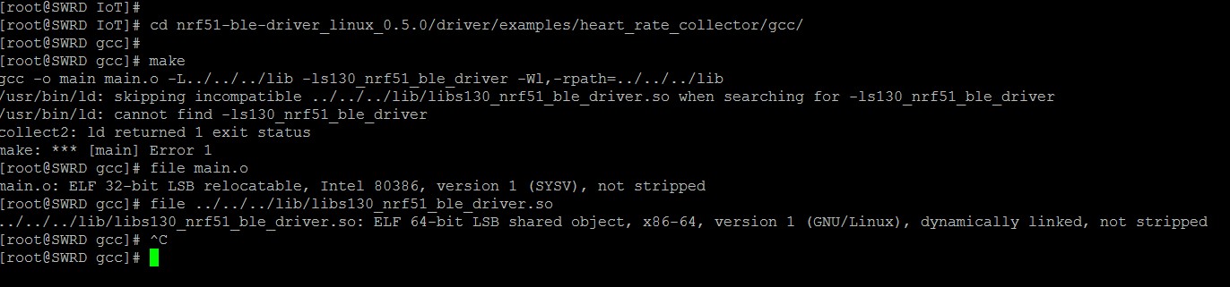

A make error occurs when building the heart_rate_collector example code of nrf51-ble-driver_linux_0.5.0 on my cross compile environment (Linux SWRD 2.6.32.26-175.fc12.i686).
It seems that the libs130_nrf51_ble_driver.so is incompatible for linker. Would you please tell me how can I fix the issue? and How can I get the source code if rebuilding the library is needed?
The error messages:

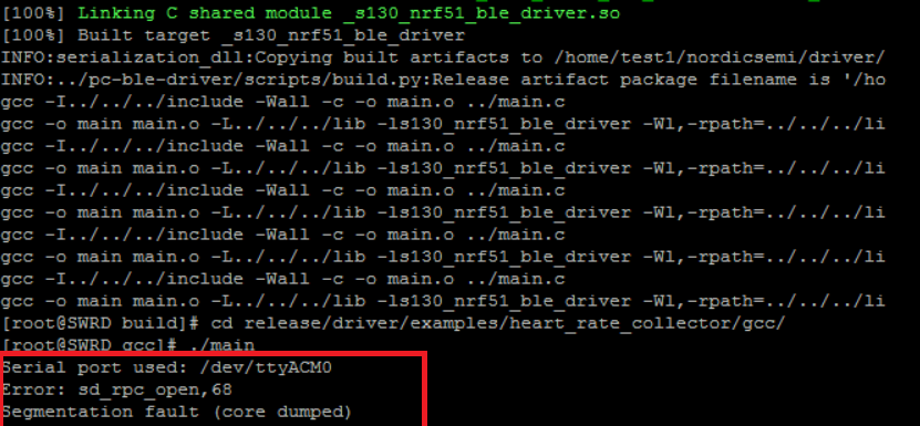

    I can build the heart_rate_collector example code on my cross compile environment (Linux SWRD 2.6.32.26-175.fc12.i686).
    But I encountered great difficulties in executing the example code, would you please help me on this.
    The error messages: image description

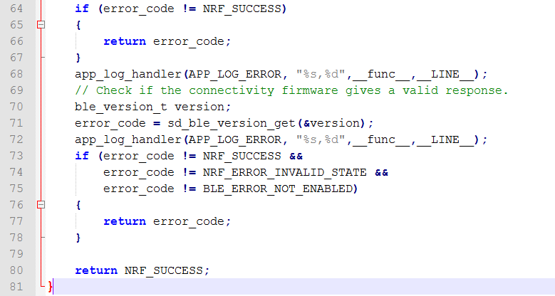

    The error code appears in sd_ble_version_get(&version) function as follows:
