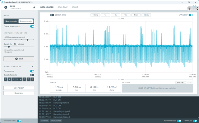

High current comsumption when GPIO and BLE enabled on nRF5340-DK
I am testing on nRF5340-DK(0.11.0) with nrf connect sdk(v2.4.0).
And Measuring current consumption.
When I added GPIO (button) to the scan_adv sample, High current consumption.
What is the problem?
modified scan_adv sample

GPIO disabled(3.62mA average)
GPIO enabled (3.99mA average)
