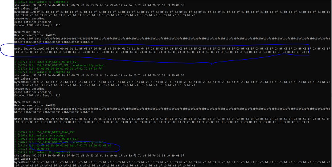

I am trying to perform the DFU on the nRF52 DK board from my esp32 board via Bluetooth with the following stack: Simple Management Protocol (SMP) + Bluetooth Low Energy (BLE).

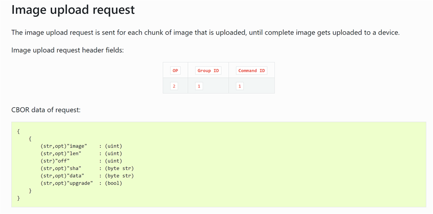

I am using the commands format shown here: developer.nordicsemi.com/.../smp_protocol.html

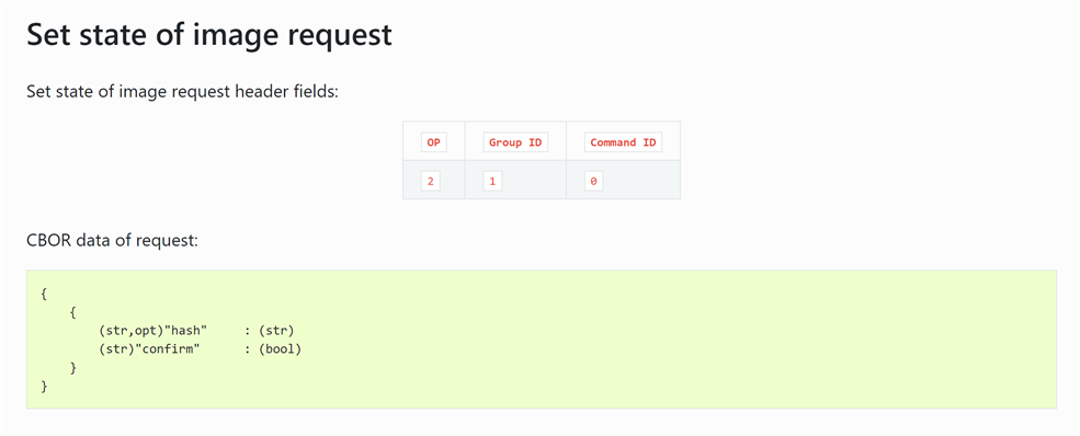

and commands from image management group shown here: developer.nordicsemi.com/.../smp_group_1.html
I first try to get the state of images and I get the following notification back
On checking for the data in CBOR i get proper values
1, 0, 0, false, 0, 1, 0, 0, {"images": [{"slot": 0, "version": "0.0.0", "hash": h'3B8B8664F91875B456BCC769242680B0657BD48A599A41B7F94CD83D89F4F32D', "bootable": true, "pending": false, "confirmed": true, "active": true, "permanent": false}, {"slot": 1, "version": "0.0.0", "hash": h'82AD183C3DC099B9D4A4E94CBE7EF58E6F7671415C4B96F17000BCDE096A322B', "bootable": true, "pending": false, "confirmed": false, "active": false, "permanent": false}], "splitStatus": 0}
where the initial 8 bits are response(though not mentioned on the above-mentioned webpage with command details) and then further expected response about the expected 2 images on the board.
Next, I try to upload the image on the board in .bin format using the command shown on the webpage
I am sending the following CBOR data(just few bytes for example, shown in red). The actual command +data and response is shown in blue. As evident from the response I get an error with error code 0x3. There is no RSN sent to get details. Now, I thought probably the data is not in the proper format or there is some discrepancy in the way CBOR data has been depicted to be sent on the webpage. So, I tried sending in a format where there is CBOR data within single brackets { ..} instead of two brackets(which(two brackets) I find absurd as any CBOR decoder is not able to handle it). If I send it within single brackets I again get back error. I tried only the compulsory field of offset and data in the first packet and also the proper format for first packet with all fields for offset 0. Still I keep getting response with error code 0x3. I tried multiple combinations but nothing works.
Now, I tried to send the command to set the state of image to find out the format expected for the commands as its CBOR data is in a similar format with two brackets.
I tried sending in the format as shown on the webpage with only the compulsory field of confirm, just to see if I get a response. No matter what combination(single bracket, two bracket) I try it gives an error when I just send the confirmation field value in CBOR data.
But then when I try to send the Set Image state command with CBOR data containing both fields in CBOR data: conform true and hash value(for the image in slot 1 ), I do not get any response from the nrf board.  But when I try to get the image state again to see what happened, I see the state of the image in slot 1 has changed to "bootable": true, "pending": true. That means that data is supposed to be sent in single brackets and not inside two brackets.
Command to set image state in red and response for image state in blue.
3, 0, 0, false, 0, 1, 0, 0, {"images": [{"slot": 0, "version": "0.0.0", "hash": h'82AD183C3DC099B9D4A4E94CBE7EF58E6F7671415C4B96F17000BCDE096A322B', "bootable": true, "pending": false, "confirmed": true, "active": true, "permanent": false}, {"slot": 1, "version": "0.0.0", "hash": h'ECA54C38C1CCB868DB8367C562E25DB806230044E137E35467C818589A421E87', "bootable": true, "pending": true, "confirmed": false, "active": false, "permanent": true}], "splitStatus": 0}
After a reboot I see the image in slot 1 has moved to slot 0 and is the active image and image in slot 0 has moved to slot 1 as expected.
1, 0, 0, false, 0, 1, 0, 0, {"images": [{"slot": 0, "version": "0.0.0", "hash": h'ECA54C38C1CCB868DB8367C562E25DB806230044E137E35467C818589A421E87', "bootable": true, "pending": false, "confirmed": true, "active": true, "permanent": false}, {"slot": 1, "version": "0.0.0", "hash": h'82AD183C3DC099B9D4A4E94CBE7EF58E6F7671415C4B96F17000BCDE096A322B', "bootable": true, "pending": false, "confirmed": false, "active": false, "permanent": false}], "splitStatus": 0}
Now, I went back and tried to send an image upload request with CBOR data within single brackets, but again get a response in notification with an error 0x3.
So, now I want to know
1) how exactly am I supposed to send the Image Upload Request and its data for uploading an image on the NRF52 for a DFU.
2) What format is the update image is supposed to be in .bin, .hex, .zip ?
3) What order of commands do I have to follow to perform a DFU from the image management group ? Do i need to provide a special command to enter bootloader mode or anything special needs to be done before sending image upload request?
4) Can you clarify the exact format for the CBOR data in the commands for image management group?

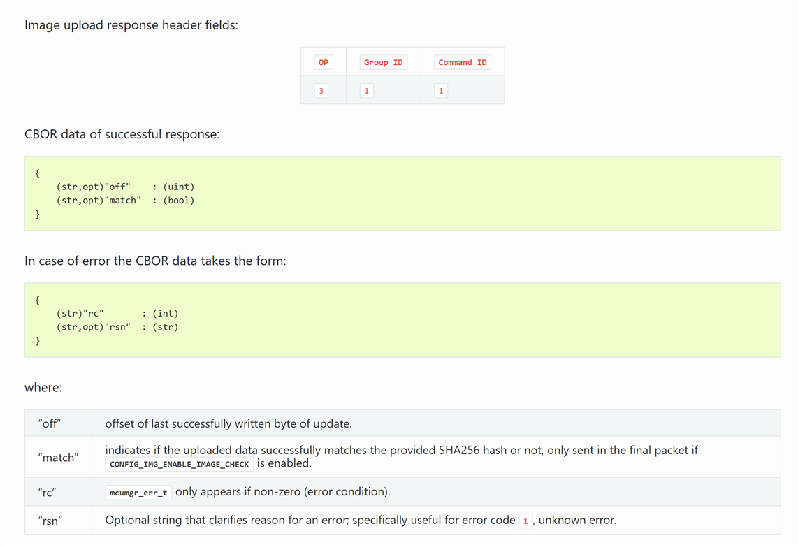

  • I tried again sending continous packets of 100 bytes for the image and for the first packet(with all optional and compulsory fields for image upload command)   i still get error 0x3. But for next set of packets like i show below for offset 100 i get response saying rc is 0 i.e. no error and i get off field also with value 0 as shown below.
    Now, this is like in between of a positive and negative response as it has rc as well as off in response. Can you explain what is happening here?

    I captured a HCI trace from the DFU target (nRF52840 running SMP server) when being updated by the nRF device manager app on iOS.
    Here's the first image upload request received by the dfu target:
    The following upload commands can be found in attached trace file (can be opened in Wireshark).
    smp_dfu.pcapng
    I will ask internally about the sequence number and get back to you. I assume the image size can't be limited by the bit width of this field.
