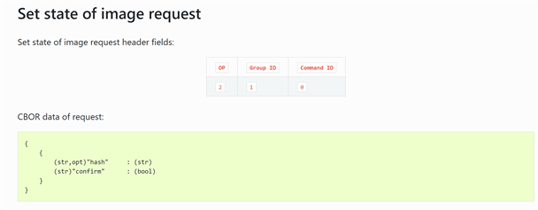

Now, I tried to send the command to set the state of image to find out the format expected for the commands as its CBOR data is in a similar format with two brackets.
I tried sending in the format as shown on the webpage with only the compulsory field of confirm, just to see if I get a response. No matter what combination(single bracket, two bracket) I try it gives an error when I just send the confirmation field value in CBOR data.
But then when I try to send the Set Image state command with CBOR data containing both fields in CBOR data: conform true and hash value(for the image in slot 1 ), I do not get any response from the nrf board.  But when I try to get the image state again to see what happened, I see the state of the image in slot 1 has changed to "bootable": true, "pending": true. That means that data is supposed to be sent in single brackets and not inside two brackets.

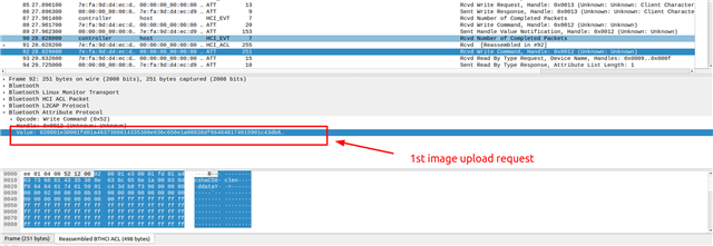

    I captured a HCI trace from the DFU target (nRF52840 running SMP server) when being updated by the nRF device manager app on iOS.
    Here's the first image upload request received by the dfu target:
    The following upload commands can be found in attached trace file (can be opened in Wireshark).
    smp_dfu.pcapng
    I will ask internally about the sequence number and get back to you. I assume the image size can't be limited by the bit width of this field.

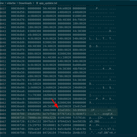

    I'm happy to hear that you have made good progress on this. With regards to the image hash, it is stored in the image trailer of the app_update_binary and is computed over the image header and body (see IMAGE_TLV_KEYHASH).
    The IMAGE_TLV_KEYHASH value in the app_update.bin you uploaded:
    app_update.txt
    I assume you are able to confirm the image if you use the hash you received in response to your image state request?
  • Hello Vidar,
                        Thank you for the update. Yes, I was able to confirm the image using the hash I received in response to your image state request. I read the link you pointed to but I still cannot understand if there is a fixed offset (either from the end or beginning) from where I can read this hash? If not, then how can I move to the offset where I have to read the hash value? I mean I cannot understand reading the text how the complete image is structured and if the image header starts from the beginning or not( It doesn't look so). Can you explain to me how I can find out the hash value from a bin file?
    Vineet
  • Hello Vineet,
    The hash is included in the image trailer located at the end of image slot. To find the exact location for the hash digest, you can parse the TLVs following the magic word (0x6907) as shown in the image in my previous reply.
