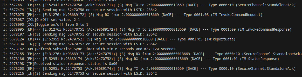

When pressed, the matter message reaches the NRF device.
My problem now is that i cant seem to find the possibility in the code to process this message.
I am stuck on trying to handle the message.
One approach is to implement a function "MatterPostAttributeChangeCallback(const chip::app::ConcreteAttributePath & attributePath, uint8_t mask, uint8_t type,
uint16_t size, uint8_t * value)" in the zcl_callbacks.cpp (allthough i dont think the file name matters) as seen in this guide:
Creating Matter accessory device — nRF Connect SDK 1.9.2-dev1 documentation (nordicsemi.com)
In my other approach i had a look at the working ESP32 matter lighting example and implemented the callback simultaneous:
In the class "AppDeviceCallBacks" that is extending the "CommonDeviceCallbacks.h" (from the connectedhomeip CHIP repo) i implemented a function "virtual void PostAttributeChangeCallback(chip::EndpointId endpointId, chip::ClusterId clusterId, chip::AttributeId attributeId, uint8_t type, uint16_t size, uint8_t * value)"
All of these new files are of course added to the CMakeLists.txt in target_sources section, so they will be included / compiled.
Compiling and flashing works, but HA On/Off message arent triggering my functions.
Can anybody please help me "connectring" the incomming call to my code?
