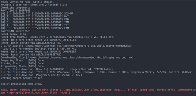

FATAL ERROR: command exited with status 1: /opt/SEGGER/JLink_V770e/JLinkExe -nogui 1 -if swd -speed 4000 -device nrf52 -CommanderScript /tmp/tmp9lqsoklajlink/runner.jlink -nogui 1
I am getting an error when I try to flash my device with j-link (see capture I attach) and this is some information I have:
-I can flash correctly with zephyr 3.2.0 vanila but now that I am working with NCS 2.2.0 I get this error.
-I can flash other devices with the same microcontroller (nrf52840) and NCS 2.2.0, so I just get this error in one of the devices I have.
I hope you can help me and I can provide you all information you need.
Best regards

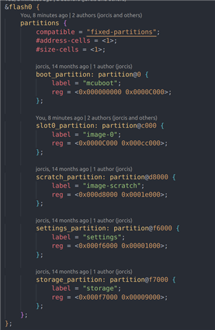

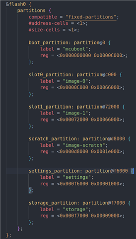

  • Hello, thanks for answering, maybe I don't express myself well, I have two projects with ncs 2.2.0, I can flash one of them, but the other returns the error that I showed you, so it seems that the error is in the code.

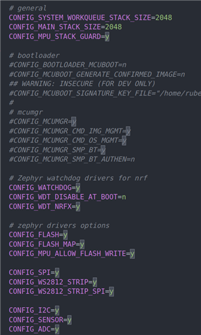

    I've been trying to figure it out all morning and seems that the problem is lack of memory since I can flash without debug but I can not with debug options, this is my memory partitions:
    and I would like to be able to debug in order to find bugs and test correctly, I tried to comment bootloader and mcumgr but seems is not enough

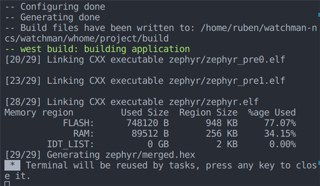

  • Hi Naeem, the thing is that I tried to reduce the size and just now my flash says 77% and It stills not working I realized It just fails when the flash is larger than 50% and I do not know why this behaviour, I though this was because I have 2 images for dfu upgrade so I decided to erase slot1_partition and increase slot0_partition but It still not working, I do not understand... I do not know if this is a bug of v2.2.0 or I am doing something wrong...

    I was trying to flash with another projects which flash memory used was larger than 50% and It worked good so seems the problem is only for that project and not hardware.
    -In the past I was working with zephyr vanila and everything was working fine but now that I work with nrf 2.2.0 I have troubles, you can see that is not allocating correctly the application when I use west flash
    -I only get to flash with the next comand correctly nrfjprog -f nrf52 --debugreset && nrfjprog -f nrf52 --program build/zephyr/zephyr.hex --sectorerase --verify && nrfjprog -f nrf52 --debugreset.
    -This error just happens when my memory flash used is larger than 50% so seems maybe is something related to partitions but I do not understand because I have other project that I can flash correctly so the problems seems is just related to this project.
    ¿maybe the bootloader is not working correctly? I am going to try to install NCS for VScode and try if that fixs the problem, but all this seems like a nordic bug that is not able to allocate memory correctly.

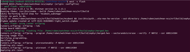

    no worries I hope your vacation were good, I have no problem when I try to flash a sample but I observed the proces when I use the comand west flash is not the same for a sample of nrf than for my application:
    This is for an nrf sample, seems that flash a ile called merge.hex
    This is for my aplication, I think just flashes zephyr.hex:

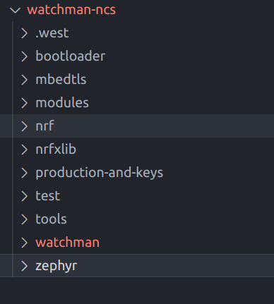

    Maybe I added my project incorrectly? This is the structure of my project (watchman):

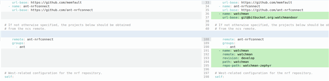

    This is how I add watchman to the project, adding those lines in the file west.yml of nrf repository

    Now as you have successfully complied the samples or other projects that are larger than 50% flash memory, the issue seems to be in the project itself. As you are using the bootloader, I suggest you to base your project on official / supported (Nordic / Zephyr) samples.

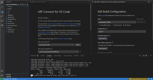

    For example, I see you have shared your folder structure. Below, I started with a sample project in NCS and then added mcuboot to it, and just sharing output of building with and without mcuboot
    1) Building peripheral uart in ncs 2.4.0

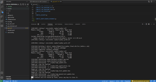

    2) Building the same sample with MCUboot:
    I have built both cases for the same build target (nrf52840). We can see the increase in flash usage and generation of different output files.
    For official MCUboot sample please refer to SMP Server, and for unofficial samples in NCS please have a look at this repo.
    BR, Naeem
