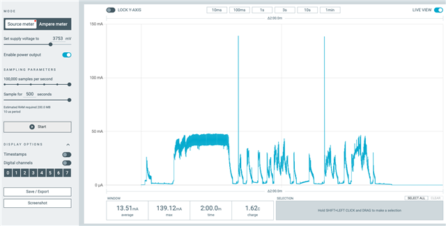

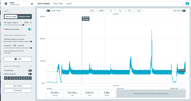

in Germany, O2/Telefonica (MCC+MNC: 26203) recently launched its NB-IoT network on a larger scale. Unfortunately, we see very high latencies (20-30s) in UDP communication with the nRF9160 compared to the other available networks (Vodafone-26202 and Deutsche Telekom-26201). In addition, we see that packets are processed in bursts, if at all, and an unusual pattern of power consumption. We cannot explain these, also due to the very good network coverage. Therefore, I would like to ask here for an analysis by suitable person at Nordic.

Once each for the problematic network of Telefonica and Deutsche Telekom. Both show a completely different behavior. Whereas the modem at Telefonica permanently needs 25mA+peaks, this is not the case at all at Telekom. See also these two pictures for comparison:
Telefoncia Power Consumption (high latencies) Telekom Power Consumption (low latencies)
I hereby ask someone at Nordic to look at the attached traces in comparison to each other and to assess what the problems at Telefonica could be and whether a malfunction of the modem can be ruled out. The communication is deliberately kept simple and unencrypted so as not to distract from the real problem. But I can say that the normally used DTLS secured communication with such high latencies and the current implementation in nrf-modem does not work or only very unreliable.

    In NB-IoT, the network can automatically allocate uplink (UL) resources for a device (UE, short for User Equipment, in LTE-spec-speach) to send data or UE can request UL resources with RACH procedure. logicalChannelSR-ProhibitTimer (~16 s) is started when data becomes available and timer expiry will trigger RACH procedure if NW has not allocated UL resources before that. After each UL allocation retxBSR-Timer is started (~16s) and timer expiry will also trigger RACH procedure if there is data waiting for transmission.
    In this case, one UL allocation is received after successful PDN activation. There is no data available for transmission yet and padding is sent instead, and the retxBSR timer is started. After that socket is opened and data is sent, but the network does not send new UL allocations, so no data is sent before the retxBSR timer expires and the UE requests UL resources.
    The modem team means that the device works as expected. To reach fluent data flow with this NW configuration NW should allocate UL resources more frequently. After a successful PDN activation only one UL allocation is received.
    thank you.
    Over other channels I got also the information that this issue has been fixed in the O2/Telefonica network for 1/2 basestation vendors. So it might be solved in the future once they update also the 2nd vendor of base stations.
