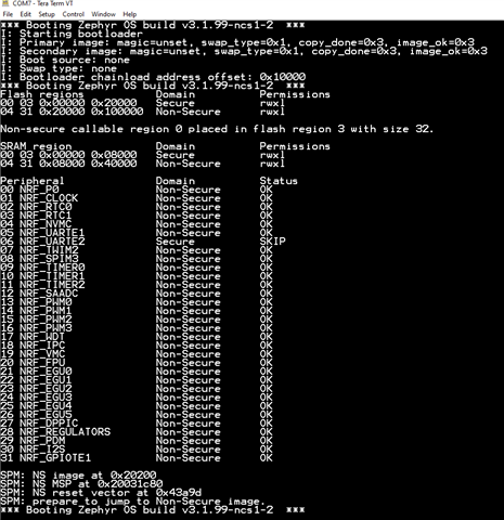

Error: "region `FLASH' overflowed by 5164 bytes" occurred after enabling image signing for mcuboot
I was facing below warning that I am using default MCUBoot Key, which I should not use it for our production. I was new to this topic and wanted to resolve this issues asap. Because we will be certifying our product very soon with Verizon and I hope this was a crucial step to remove this warning before certification.
CMake Warning at C:/Users/Chetan.Kale/nordic_ncs/v2.1.3/nrf/modules/mcuboot/CMakeLists.txt:286 (message):
          --- WARNING: Using default MCUBoot key, it should not ---
          --- be used for production.                           ---

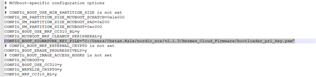

So to remove this warning I created a private key using openssl using below cmd in bash window and added below prj.conf and kconfig options.
prj.conf
CONFIG_SECURE_BOOT=y
kconfig
config BOOT_SIGNATURE_KEY_FILE
	string "Firmware Signature File Absolute Path"
	default "C:/Users/Chetan.Kale/nordic_ncs/v2.1.3/Hermes_Cloud_Firmware/private.pem"
OpenSSL CMD
openssl ecparam -name prime256v1 -noout -out private.pem
Although, after performing above changes the warning seems to be removed in the logs but the build is failing with the error stating that "region `FLASH' overflowed by 5164 bytes". Please refer complete logs below and a new warning appears mentioned below.
New Warning:
CMake Warning at ../../subsys/bootloader/CMakeLists.txt:21 (message):
        --- WARNING: When using the immutable bootloader on  ---
        --- this SoC, the UICR must be erased when flashing. ---
        --- E.g. by calling 'west flash --erase'             ---
Complete Log: (Somehow I am not able to attach the log in <\> option so attaching it below.)

  • Okay, I was suppose to say that. So what I did is I added the my private key absolute path to mcuboot.conf file.
    CONFIG_SPI=y
    CONFIG_SPI_NOR=y
    CONFIG_SPI_NOR_FLASH_LAYOUT_PAGE_SIZE=4096
    CONFIG_MULTITHREADING=y
    # MCUboot requires a large stack size, otherwise an MPU fault will occur
    CONFIG_MAIN_STACK_SIZE=10240
    # Enable flash operations
    CONFIG_FLASH=y
    # This must be increased to accommodate the bigger images.
    CONFIG_BOOT_MAX_IMG_SECTORS=256
    CONFIG_PM_OVERRIDE_EXTERNAL_DRIVER_CHECK=y
    CONFIG_BOOT_SIGNATURE_KEY_FILE="C:/Users/Chetan.Kale/nordic_ncs/v2.1.3/Hermes_Cloud_Firmware/bootloader_pri_key.pem"
    After build I see that the path in .config file has changed to my private.pem file.
    And after flashing the firmware it worked.
