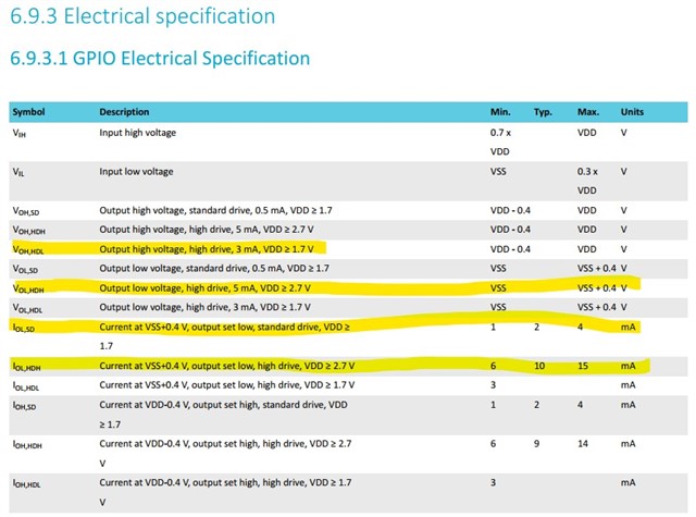

    My sensors will draw about 5mA each when running. Luckily, they have a OK power-up-time of 3ms. So I plan to actively control the GND line to the sensor in order to switch it off when the µC is sleeping. This will extend the uptime to 7-8ms but I guess this is still OK. I calculated about 30 days battery live for this combination of sensors an µC and this is more than enough.
    However, on the active controll of the GND-line: Is the nRF528xx able to sink 5mA via its GPIOs or do I need an external transistor? I have more then enought GPIOs. So I could dedicate one separate GND-supply pin for both sensors.
    Edit: I already have a Adafruit Feather nRF52840 here for first tests and tried to power the sensors from GPIOs  yesterday evening and it worked fine. So test confirms that its working. I also found the relevant value in the product specification. So 5mA is about one third of the specified max value. I should be fine. No further questions.
