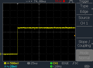

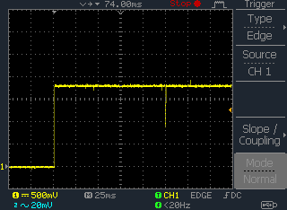

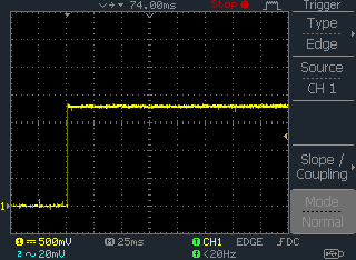

  • Hi Helsing!
    Sorry for the delay - I finally managed to do some meassurments...
    Seems, that the Ooredoo SIM is 3.0V.
    The Ooredoo SIM is working with a GEMALTO modem, but not in the nrf9160 (Icarus-Board).
     VccSIM_1NCE_Gemalto_ok:
    VccSIM_Ooredoo_Gemalto_ok:
    VccSIM_1NCE_nrf9160(Icarus)_ok:
    VccSIM_Ooredoo_nrf9160(Icarus)_FAIL:
    Any idea, why 3.0V SIMs are not working?
    BR
    Michael
